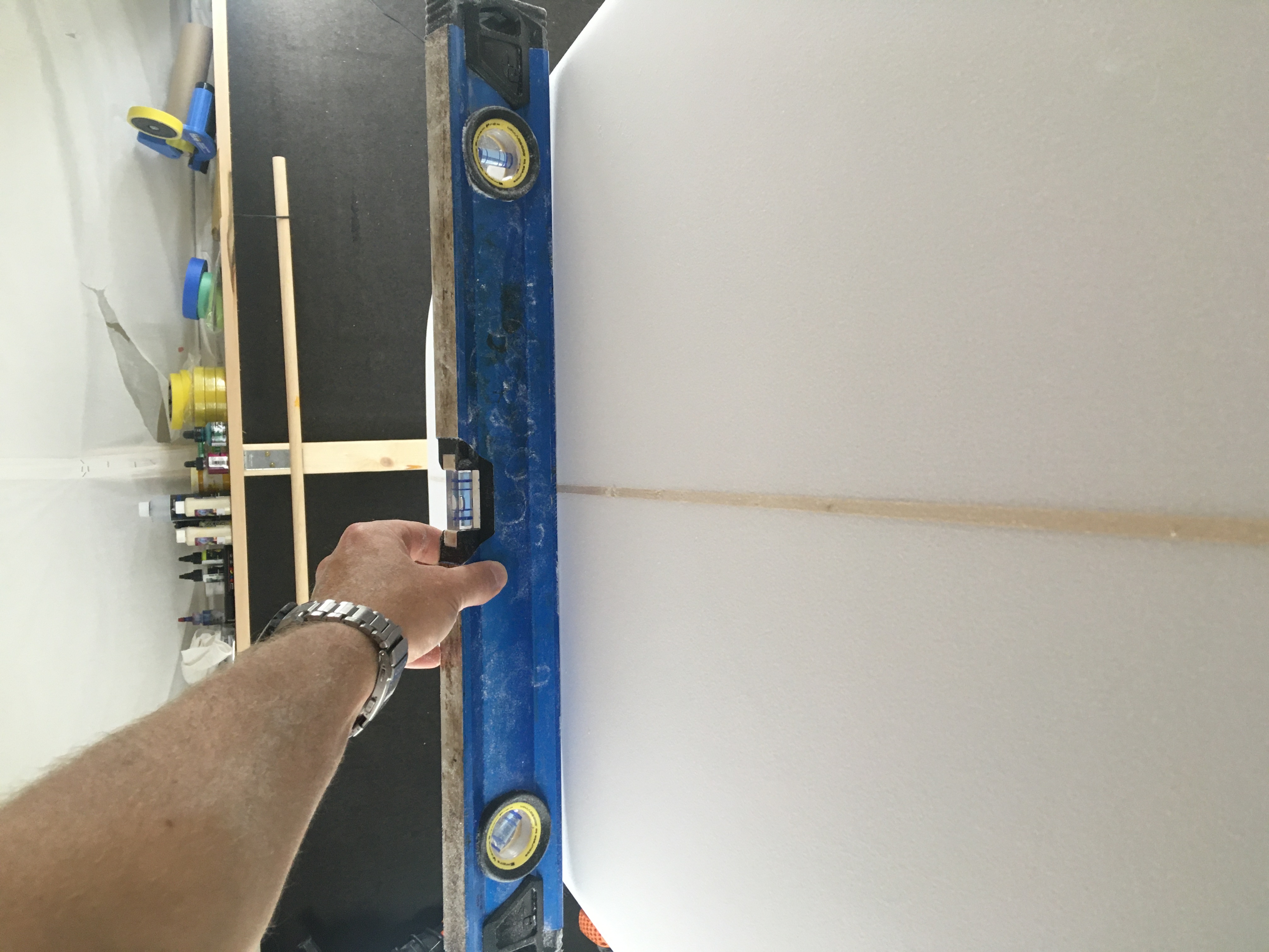

got the cut and rocker plus thickness planed out. Added 1/2" to the tail and kept the nose. Ended up being 3" TR and 4.25" NR. Started with a 8'4SP.
Took the thickness down to 3" exactly so will probably end up with 2 7/8" thick once the top is planed.

By the way, your bottom photo with the level, looks spot on. Very well done.
