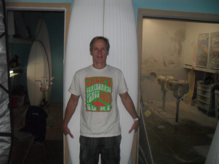

cjsurf's picture
Joined: 10/18/2009
mr ding and a sup fresh from his multiple axis machine
