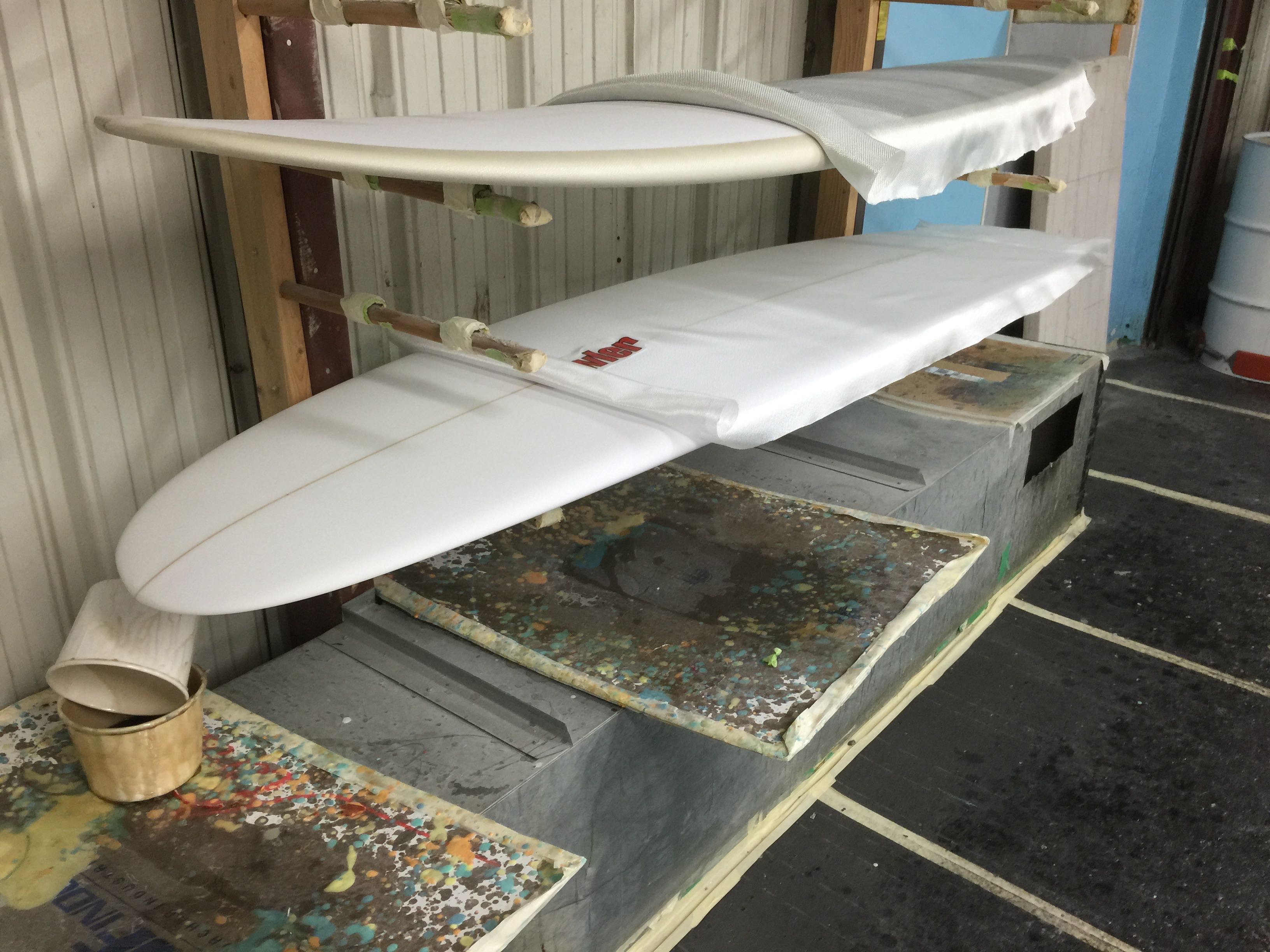

I'm currently shaping about 20 of these ranging from 6'6" to 8'6" in length. The ones shown here in front of the glass shop are 7'2" & 7'4" they run 23-1/2" x 2-5/8".
Here are some pix of Hawk laying up one with Vinylester resin before & after the resin cures. Efrain is also shown working on another batch of regular UV polyesters. The cured Vinylester has that 1960's longboard look to it and the stuff is really strong. Renny (Yater) has been doing quite a few of his Spoons with the stuff.
These boards go really good and absolutely haul ass in 1 to 5 ft. crap soft surf and can ride even bigger facey waves with no push. I'm supplying Volan Hand Foiled Greenough fins with these boards.

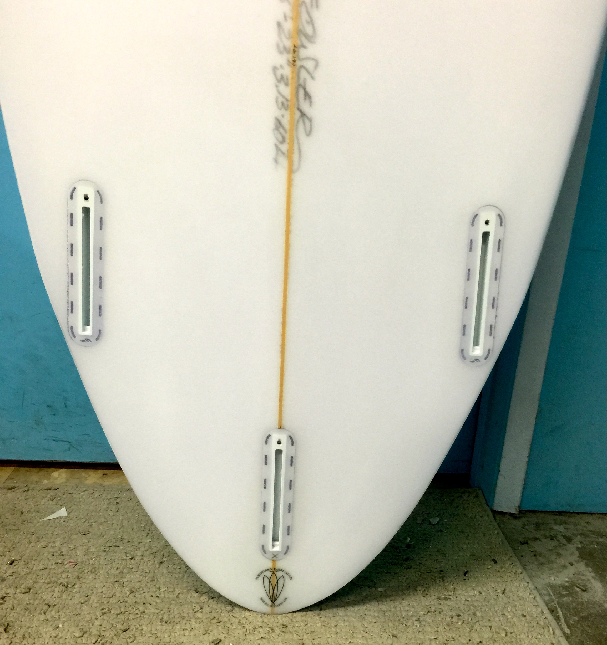

Another go out from Jeff in Fl........ 7'9" V8 lean machine... he has the 15" long box as I make this std. on all the ones over 7'6".
"Got the V8 out in some 1-2 south swell.Moved the fin to 12" from tail. Went crazy.Way more tail control.Faster and nose rides well.Can still slide the fin out on a turn but way more drive.

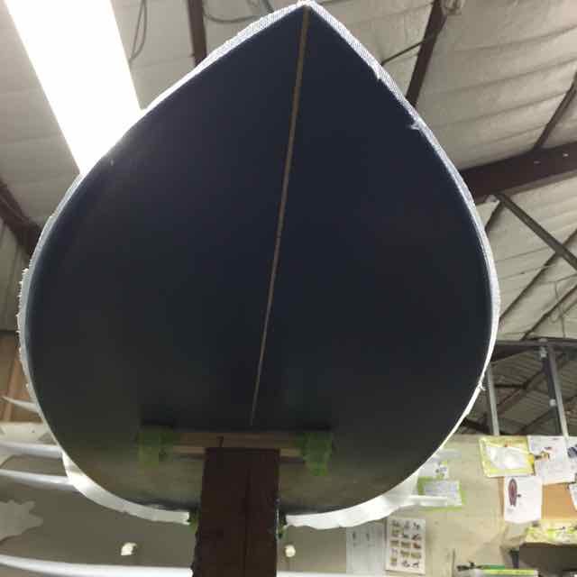

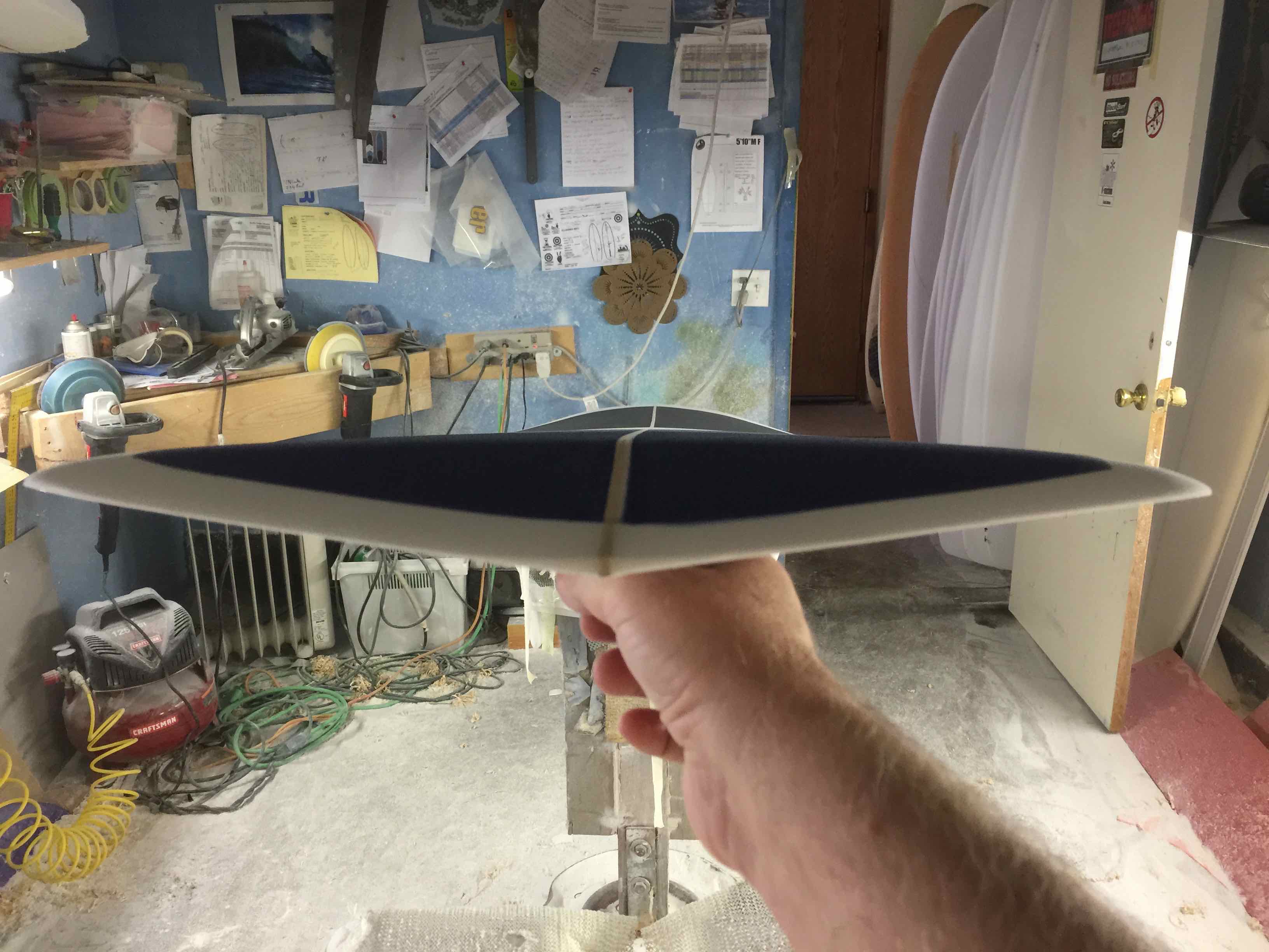

Shaped a 6'10" from an 8'0" and the board inside the board pattern really became apparent. The 6'6" having the speed and drive of a 7'9" and the 6'10" an "inside jobbie" of an efficient 8'0"....... yet both lacking the restrictions of previous nose & tail lengths of their longer predecessors.
The late Bob Krause once said to me "if you want to cruise, get a canoe, wanna go fast, chop it in half".
By that thinking a 5'10" will be 'inside' a 7'0" and a 6'2" inside a 7'4"....... initially I was only offering these from 6'6" to 8'6", but now I know they will go smaller..... probably to 5'6"....... the 6'6" & 6'10" have a lot of board for the length.
It is a formidable challenge reading foam of an already milled blank intended for other use, just to avoid distorted bottom or deck rail lines, not to mention the foil. But I've also seen merit in doing it this way versus building a board from scratch on the computer. Ironically, the result that I've gotten now, would work even better for a file than had I done it another way..... I've realized that to make versatile files for scaling, this is one helluva good way to do it! The primary reason I'm saying this is because the fullness of curve that I've been able to create can now be proportinately scaled down into much narrower widths while maintaing the fullness of the orginal curves.
I've developed a mathematical formula based on percentages that works in conjunction with the release aspects of the deep vee (1" to 1.5") panels and bottom rocker while allowing all the boards, regardless of length, to offer fin positioning of at least 12" forward of the tailblock. I've explained to people that these are NOT tail riders.... I can't say that enough because conventional thinking has people wanting to place a big fin back further..... wrong! That will just make the board spin out and squirrley..... fin placement on these is in reverse of conventional designs. They aren't displacement hulls, but you need to think that way if you are riding one of these.
In essense, the board's "wheelbase" is determined by measuring from the trailing edge of the fin to the nose. Behind the trailing edge, it's all about release.... making it, in some weird parallel world, not totally unlike a stinger. I described it to Hawk yesterday as "a board I was looking to create that would have the speed of just before you spin out, except there is a fine line that you can control it. I want something for surfers to play with giving them a fresh perspective".
Clarificaton here: the spin out I'm talking about is from RELEASE not misplanned TURBULENCE aka WASH.

"Bruce, Lovin your v8 design. Took no time to get used to. Fin is in the center of the box. Another great one, master. Three Fowlers in my toolbox now but the v8 is my fav".
Thanks. Stede

The 2nd generation of the V8 'lean machine' intensifies.
This is a 7'2"x23-1/2"x2-3/4" heavily foiled out with the thin wide tail allowing for "rocker on demand" while turning aka torsional flex. It's a 'Tale of Two Rockers'....center & rail.... this one is for SHAWN TRACHT and he will be testing it with a 15" center long box using an assortment of fins while running it as a single.... it's original design concept, but it is also being outfitted as a "4+1" to allow for quadramania and other possibilities.
The options DOES NOT include the design being used as a 'conventional' tri fin, typical tri fin placement on this surfboard would render it useless! The only reason I entertain the quad requests is because the leverage is out at the rail and may deliver yet some unexpected torque that complements the Panel Vee & Foil that promotes flex & twist off.
The glassing schedule is specific to enhancing the torsional flex, rocker on demand scenario, with the original inspiration coming from GG's (Greenough) flex spoons, yet in my own way.
This board is after a different kind of high performance in one to five foot surf, but only limited to what the rider is willing to subject it to.

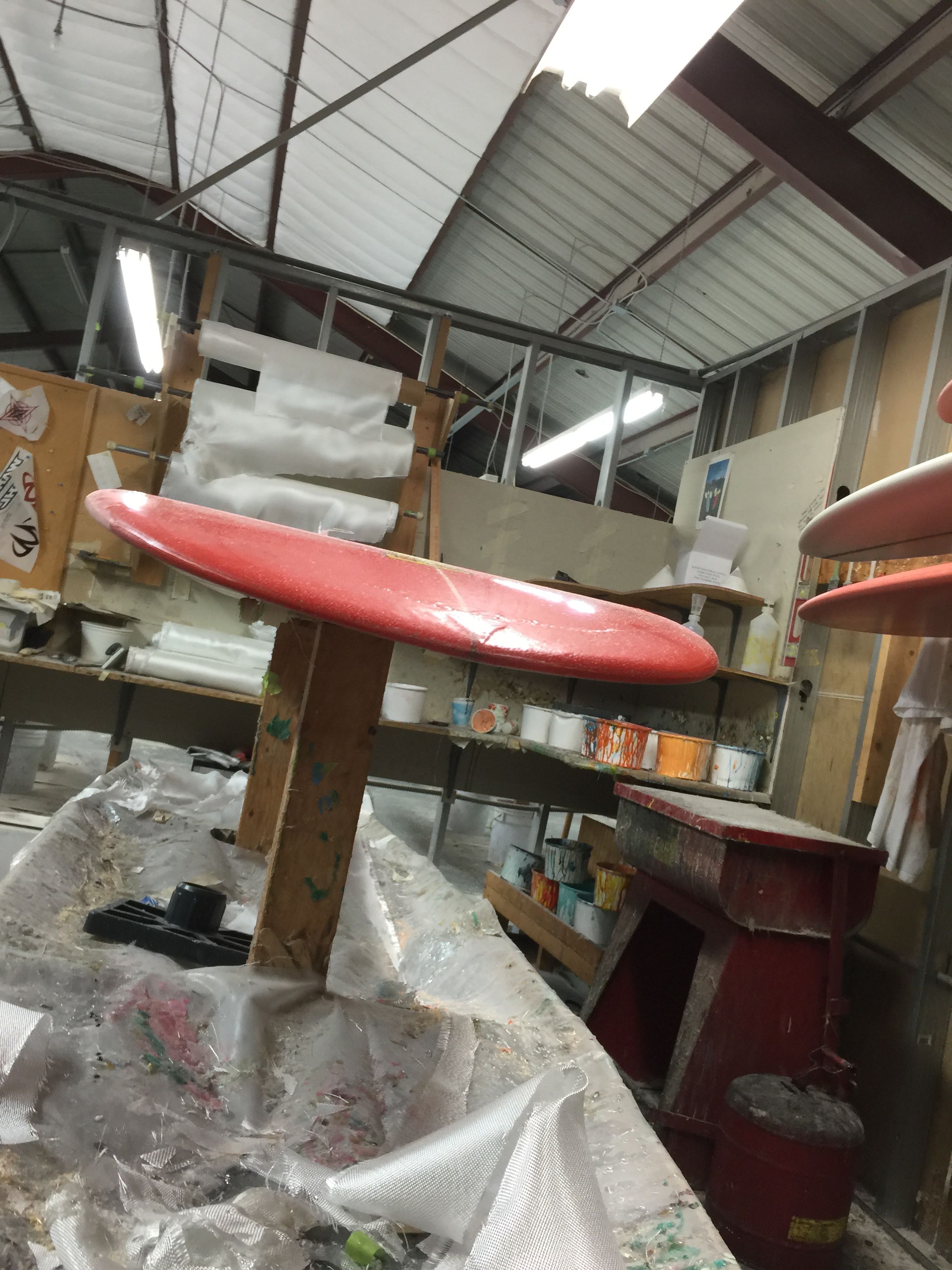

Board pictured here is sold & headed to Hawaii.
72 hours later...... board is done thanks to Hawk....... looks great.
