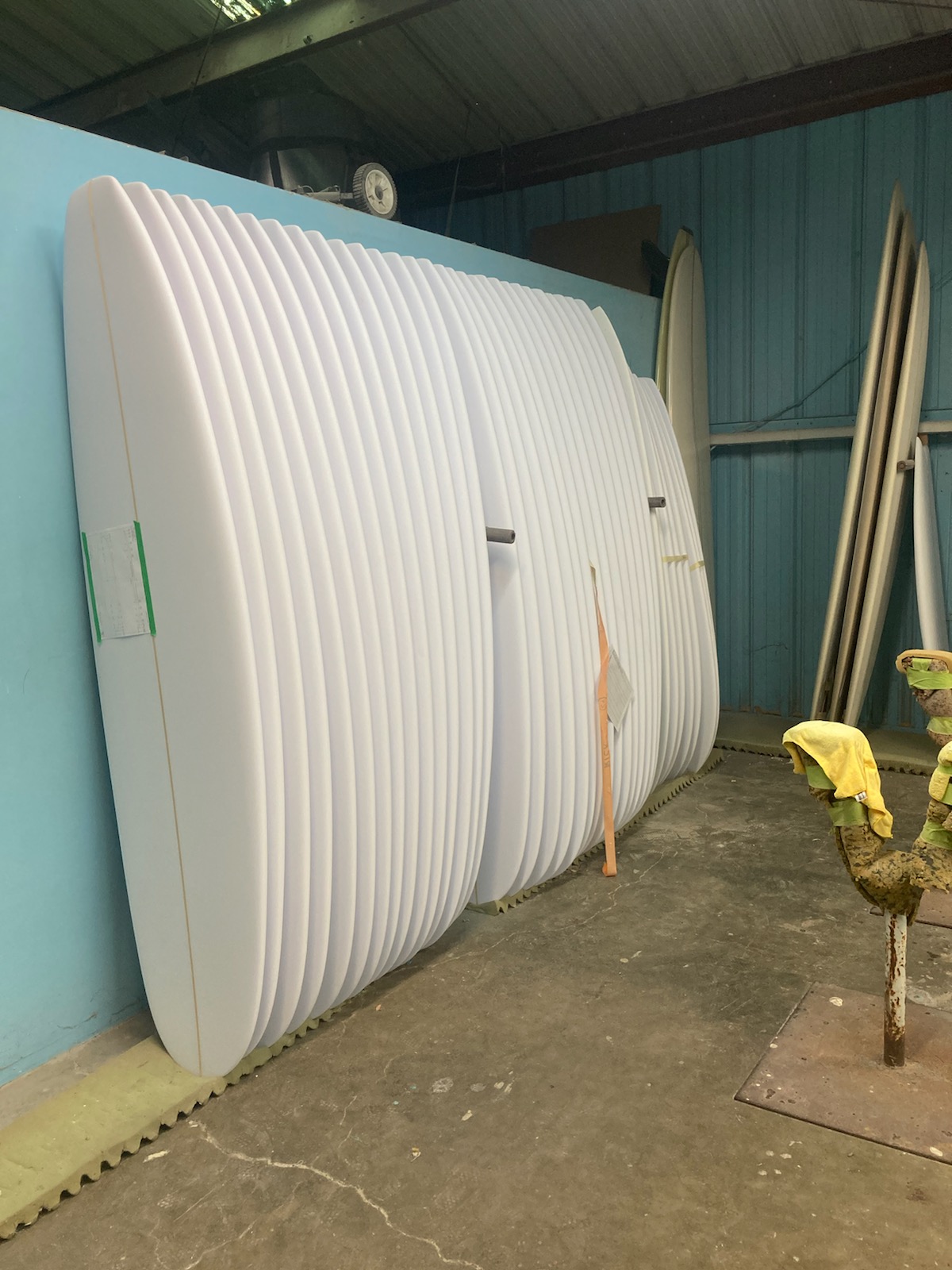

The board's are currently being glassed using Silmar's "MAP" Polyester Resin System (Modified Poly Acrylic). I'm also doing some Epoxy builds. I've used Isophthalic resin work on some of the longer boards, Conventional E Glass, S2 Glass, a bit of carbon reniforcing and will be doing some other stuff soon. More on that in the near future.
These tails have Torsional Flex, a lot of horsepower, and there is a noticeable burst of speed thru the 2nd half of cutbacks & turns. That's the acceleration from the water releasing quicker off the tails. The other advantage of the Uber Thin foiled tailblocks is that the boards go quicker rail to rail much like a narrower board while still having superior Drive & Straight Line Trim Speed. They can be tail ridden like a Classic Single or turned from the middle of the board equally well. Great for Power Surfing too.
I haven't snapped one yet. I hold the tailblock in the palm of my hand as I do the final block sanding. The thin foil is all part of the Plane Geometry I use to get the boards to perform as intended. The evolution from the old Stoker V Machines takes these boards to an all new level while maintaining the Super User Friendly attributes found in my earlier work.
Deep Panel Vee, Uber Thin Tailblock Corners, Very Specific Deck to Bottom Rail Contour that helps the Panel V & 2 Part Rocker to generate even more speed thru Turns, Cutbacks, & Straight Line Trimming.

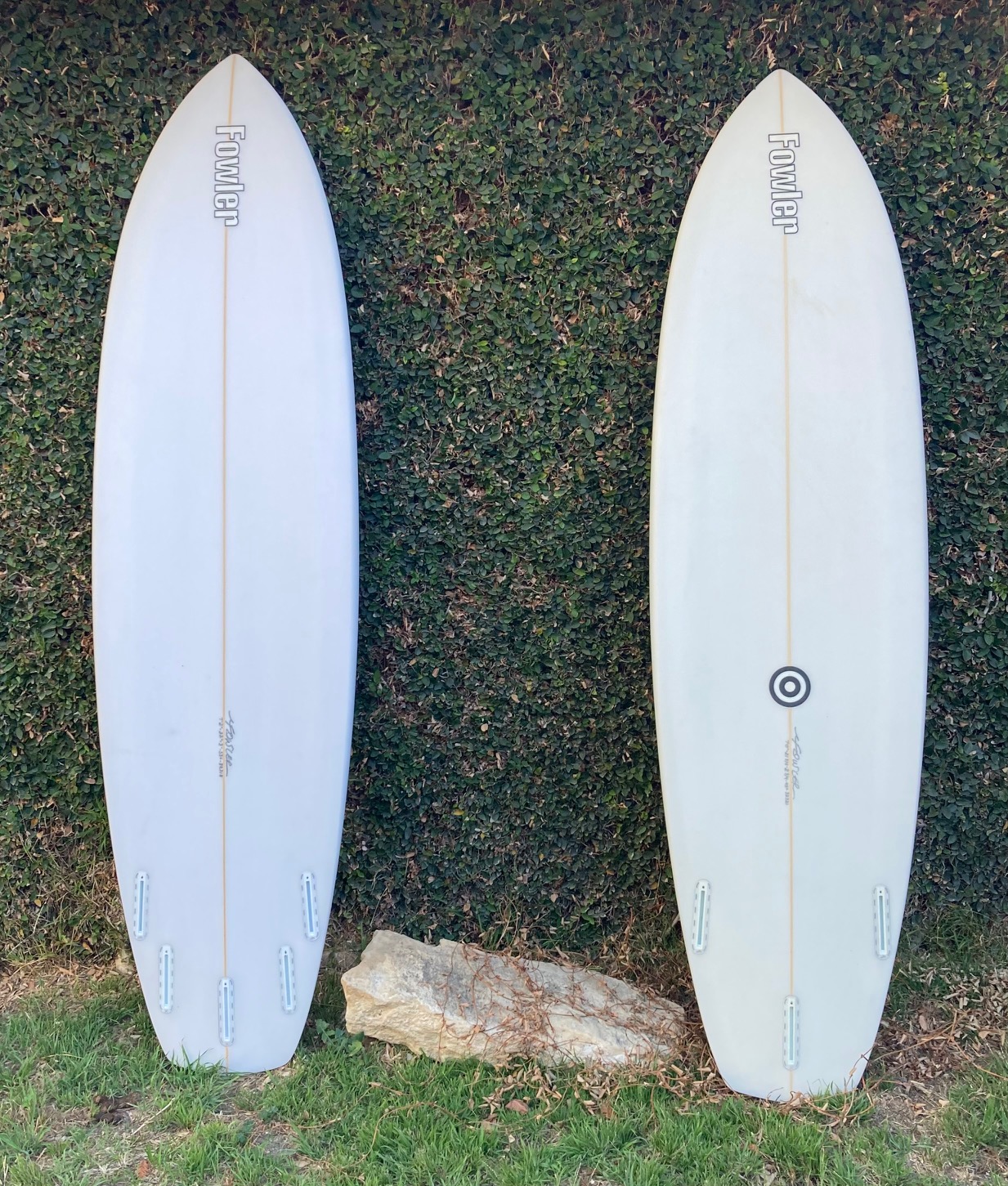

The Honey Badger is definitely a solid design that appeals to surfers that want a more familiar experience if their roots stem from learning on a longboard or single fin surfboard.
HB follows the classic design concepts that those of us riding single fin shortboards thru the 1970's became so familiar with as the go to board of that era.
Thickness over the chest area for paddling, pulled in tail for hold, the bulk of the board in front of your tail riding stance that gets hurtling along after a few good pumps and turns. This type of surfboard is exactly what I, and many others rode at Rincon, The Ranch and other better quality lined up breaks along the Pacific coast.
I have owned and made many of these boards over my long and distinguished career as a shaper.
The addition of sidebiters gives a bit more traction particularly if the rider desires a tail with a bit more width for versatility and planing in small softer surf.
The "New Machine" is a very different kind of ride. To be honest, the Anderson Stoker V Machine is closer to the HB then what I have evolved what I now call "The New Machine". The Anderson is just a knock off of the G&S Gypsy first shaped by Mitsven in 1970. Inside of two years, nearly every label had some version of that popular design:
Nose & Tail Width about the same w/Wide Point @ Center or slightly forward.
Nose Rocker 4" to 5" for early entry
Tail Rocker 1-3/4" to 2"
Flat Bottom with slight Vee in the last 1/4 of the Tail
Soft forgiving Forward Rails either 50/50 or 60/40
Hard Tail Rails for Speed & Release.

What about the New Machine?
The many design nuances, redesigns, tweaks, advancements over ten years of doing the SVM's has resulted in a very sophisticated, yet extremely user friendly surfboard that IMHO is vastly superior to the early design - including the SVM's I shaped.
The reason why I continue to have a high percentage of return customers and quiver builders is because the boards work with a high degree of accuracy of my design intentions and what my Model Descriptions promise.
W/O any disrespect to the Honey Badger or other Round Pin designs..... designs that I find very appealing to the eye btw...... I have no doubt in my mind that my New (V) Machines paddle into waves earlier with less effort and that NVM's are faster right from the takeoff and just standing on the board aka Straight Line Trim Speed.
What about that wide tail?
The big surprise for guys getting on the NVM's is that the Uber Thin Foiled Tail block and Deep Panel Vee turn rail to rail like a narrower tailed surfboard. This was a design feature that I intentionally built into the NVM's.
Conventional wisdom is that narrow surfboards go rail to rail faster than wider surfboards. Wider surfboards inherently have more drive. Narrow boards have to be pumped frequently esp. in soft surf to carry their speed and stay up on a plane. It's a one-two-turn! one-two-turn! otherwise they bog down and sink in the water.
Not so with wide boards. They plane up early because the increased surface area generates more lift w/o the need of constant turning or hopping up & down on them.
What about the NVM rocker?
I built into the design what I term a "2 Rocker System".
We know that flat/straight is fast but not maneuverable.
Curvy is easy to turn, but slower unless you work the speed out of it.
Can you have both?
The answer is YES.
When do you need MORE ROCKER?
When you TURN.
My design combines Fast Flat Centerline Rocker with Generous Rail Rocker to give you the best of both worlds. The wide tail gives you a Ton of Horsepower for superior paddling, early entry into waves, fast Straight Line Trim Speed, this allows the boards to Carry their Speed thru Turns & Cutbacks improving most surfers riding experience.
They do this better than Round Pins & because of the tail redesign, they turn quickly rail to rail like a conventional width surfboard. So you get the best of both worlds and then some. The NVMs improve the average surfer because of these design nuances. The overall net result is an increase in hull speed, the board's ability to maneuver easily while sticking to the wave face with lots of stability and not bogging down where a narrower board would.

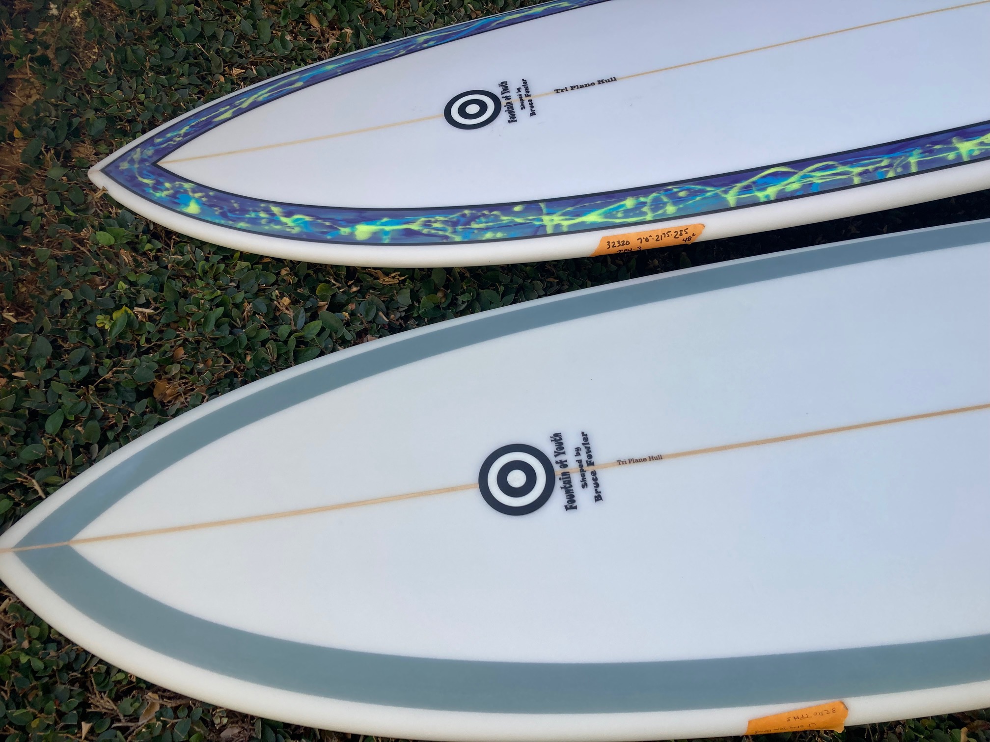

Here's a new one people may groove on a bit. It's an 8'0" BFV8 for Geoff K. Bob Haakenson did a nice job with the flaming orange resin work and the shape speaks for itself.
Been getting more orders for the BFV8's as of late. Some new ideas are in the mix and will be announced in the next month or so. Pandemic or not, lots of orders pouring in. One bummer that I just got notified of: Amtrak is suspending their Express Shipping as of September 15th until later notice.

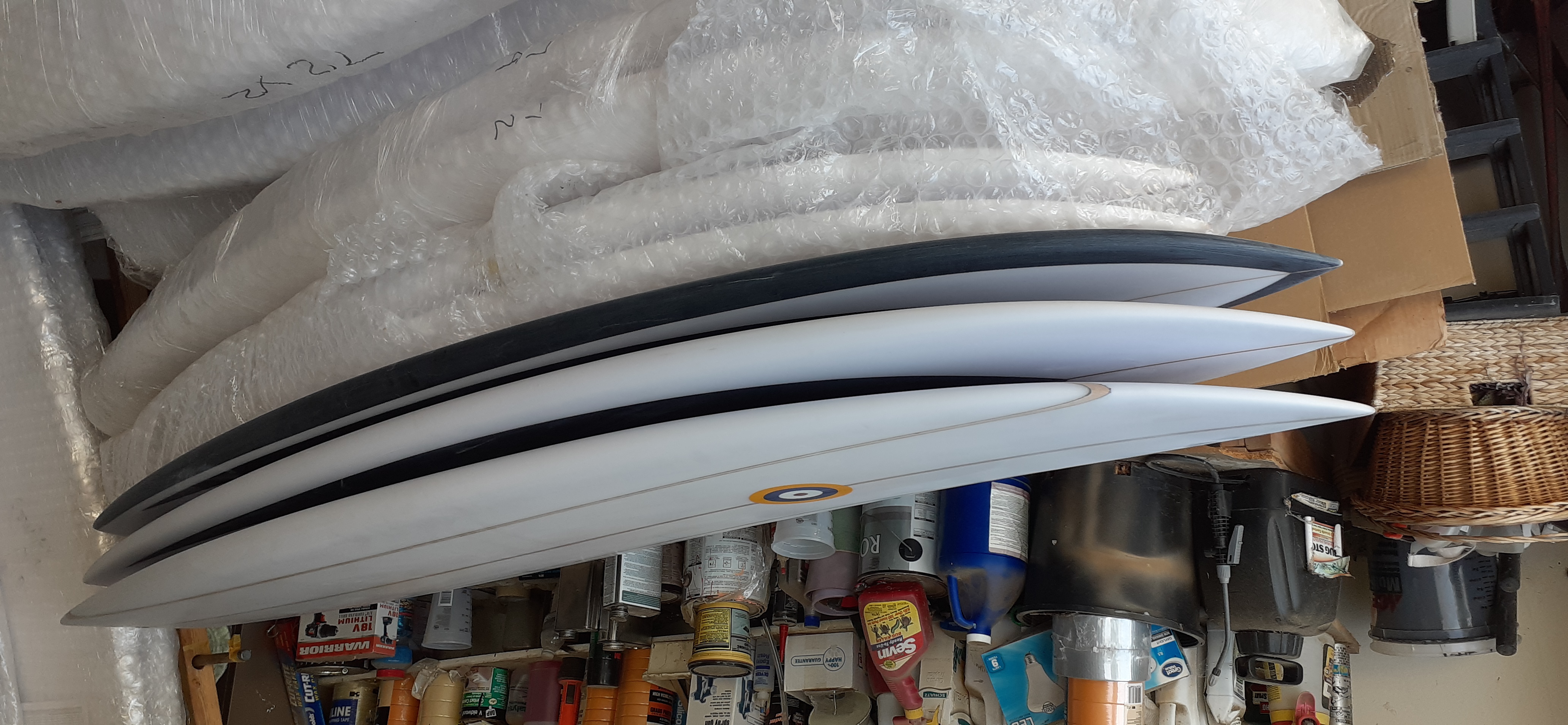

Damn, I have sent 65 boards to the East Coast for $110 in bubble wrapped then slipped into new 5mm board bags and the allowed total length up to 120" (Ten Feet). In California from San Diego to SF/SJ/Oakland $65........ $85 to Texas, Portland & Seattle. It WAS a GR8 deal. Soon to be GONE!
Luckily I have a good trucking company I am partnering with that specializes in shipments east regularly taking 3-5 days. I just sent 8 boards to Montauk NY and per board cost was $34 and change. 2 boards in a box average about $75. So far so good...... lots to ship this week.. Screwthe virus, GO! GO! GO!

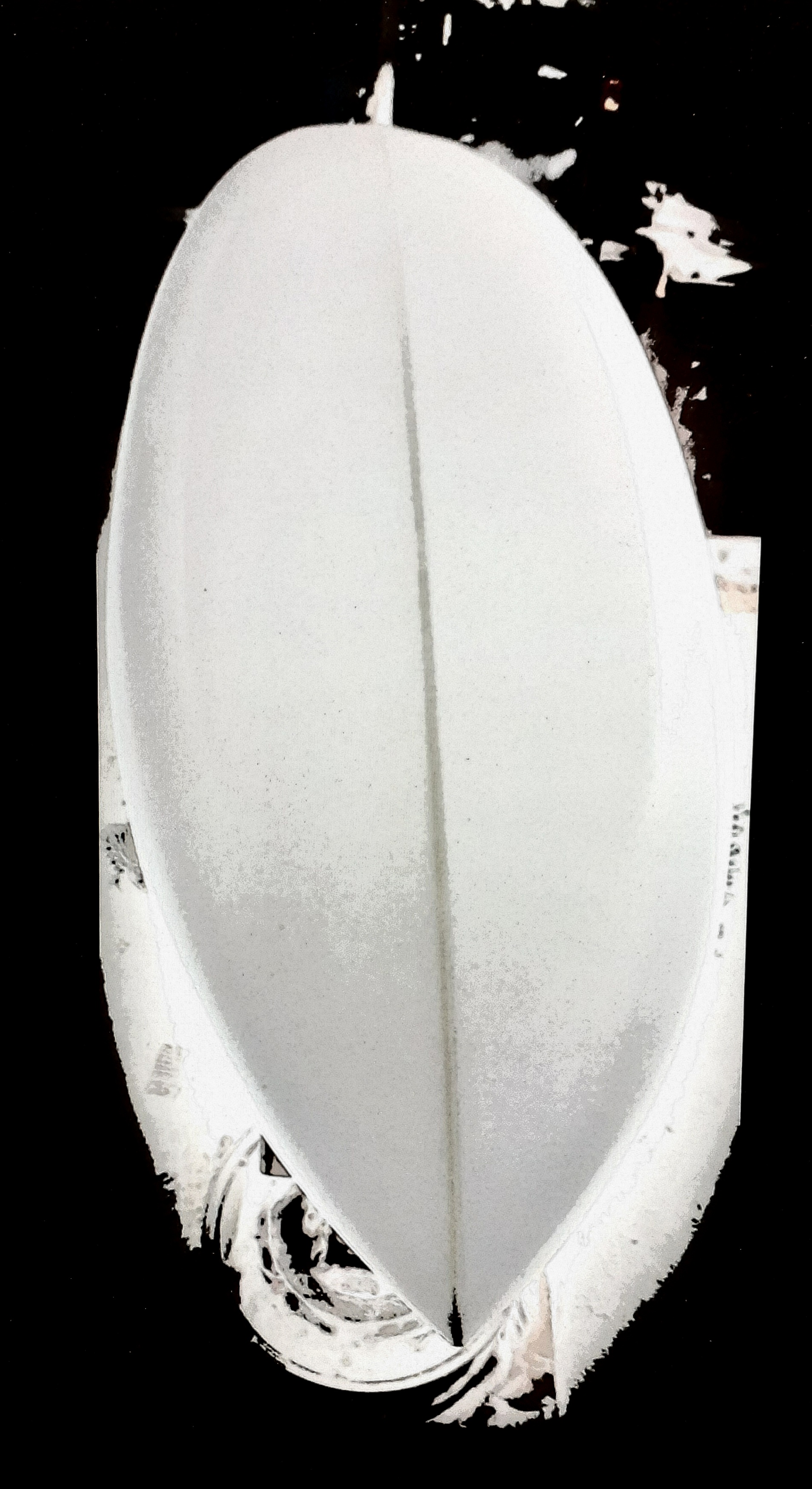

BFDE = Double Ender. 8'6"x23"x3-1/4".
Similar to a Speed Egg in many respects. Soft forgiving forward rails. A teesny bit of belly up front running fairly flat w/a smidge of roll out near the rails. The Tail Section has a Panell v Bottom with hard rails in the tail.
Relaxed Nose Rocker with Centerline Tail Rocker in the 2"s and increased Rail Rocker from the Panel Bottom.
Pretty Neutral Handler. Fast Straightline Trim Speed, Smooth Turning, Born to Carve on Rail.
1/8" Cedar Stringer with 1/2" Balsa Offset Stringers 6" out from Center. Black glueups for some drama. The Balsa wood on this blank was the DENSEST MOST CONSISTENT BALSA WOOD I HAVE EVER SHAPED.!

Here's part of the next group.
Did I mention they are FAAAAASSSSSSST?

I used to use a lot of FCS but grew disenchanted with the round X2 plugs. While I was glassing a lot of my own at home, I switched to FCS Fusion and was pleasantly surprised at how easy they were to install and how much better they were in preventing breakage than the X2 plugs, which, ironically FCS touted as their "strongest" fin attachment system.
What I found was FCS based that upon their "H Pattern" allowing a resin and cabosil mixture to attach to the deck skin when properly done. In theory, they are right. We went thru a lot of growing pains blowing out sailboard boxes while getting 50 - 60 ft of air and not perfecting the landings. We went thru endless versions of attempts toward boosting the amount of lateral stress the Bahne boxes could take before failing: woodies, lateral woodies, glassing over them, drilling & bolting each end, on and on. Eventually we developed the skin to skin connection and it eliminated the problems we'd been having. (Note: added later - we routed the fin boxes to seat w/the delrin rod footstrap inserts we were making, inadvertently creating the sts connection thereby eliminating previous problems. Then Chinook created a "one part fin box with post". The Fins Unltd aka "Bahne Box" - dsigned & patented by Bill Bahne, is, and remains, a two part molded design, with a top part & bottom plate. For ease ofproduction, the 2 part molding made economic sense. However with the higher price sailboards commanded, Chinook designed their box as a one part piece then used CNC machiney to rout the sliding track once the part had been molded........ an unique 'unibody' approach.)
However, it is different when looking at the X2 plugs. Even when correctly installed, the plugs could crack or punch thru the deck skin and they were notoriously famous for cracking at the corners of the ports that accept the fin tabs. In physics, corners are a junction point weakest to stress and load bearing pressure. A good example of this is a waterbed. If you have a square one, you HAVE TO have a frame or the corners will blow out. With a round water bed the seams handle the weight and pressure of the water 360 degrees equally along the seam. You don't need a frame with a round one.
The filler reinforcement material, and H Pattern "ring", is not enough to prevent what little plug material there is between the corners of the port and the outside wall of the plugs. Now look at the amount of material the top plate of a Fusion plug has and it's a whole different story. Couple that with high density foam, and the larger footprint, and you have a superior approach. The amount of area those 'peanuts' have toward resisting lateral pressure is vastly better than an X2 plug!
Other pluses to Fusion is that they are extremely easy to put in, and they even accept paint well if you don't want the system to be so obvious in a colored board. I used them in EPS Epoxy builds (whiich is what FCS claims they were originally designed for) and when I did builds like an opaque red, the only white that showed after sanding was the port part that the little stick tabs go over to keep resin from getting in the box. I really like that clean look.
To get back to your question however, I guess I ended up using Futures because a lot of guys like the base of the fins like Futures over the two tabs of the FCS. One screw is simpler than two. Of course the chief difference is that Futures rely on the fins being built with 6 or 6.5 degree cants whereas FCS Fusion offers boxes in 0, 5 & 8 degree cant/tilt. I offer both systems on my custom orders and over 95% of customs people want Futures. When I saw that, I deccided to go with the flow and make all the stock boards with Futures. The only exception to the rule is when I do Fish with keel style fins, and that's because I don't like the angled cut on the trailing edge of the fins (that) Futures system demands in order to install them.
HERE'S A FEW PIX. Note the first photo shows the difference between an FCSII fin and the Fusion. I offer them as an option. We've also done Robin Mair's fin boxes as they accept FCS two tab bases and it is a good system. Once in a while we do other boxes like Lok Box but it can be a pain investing in all the jigs and getting used to different installs.

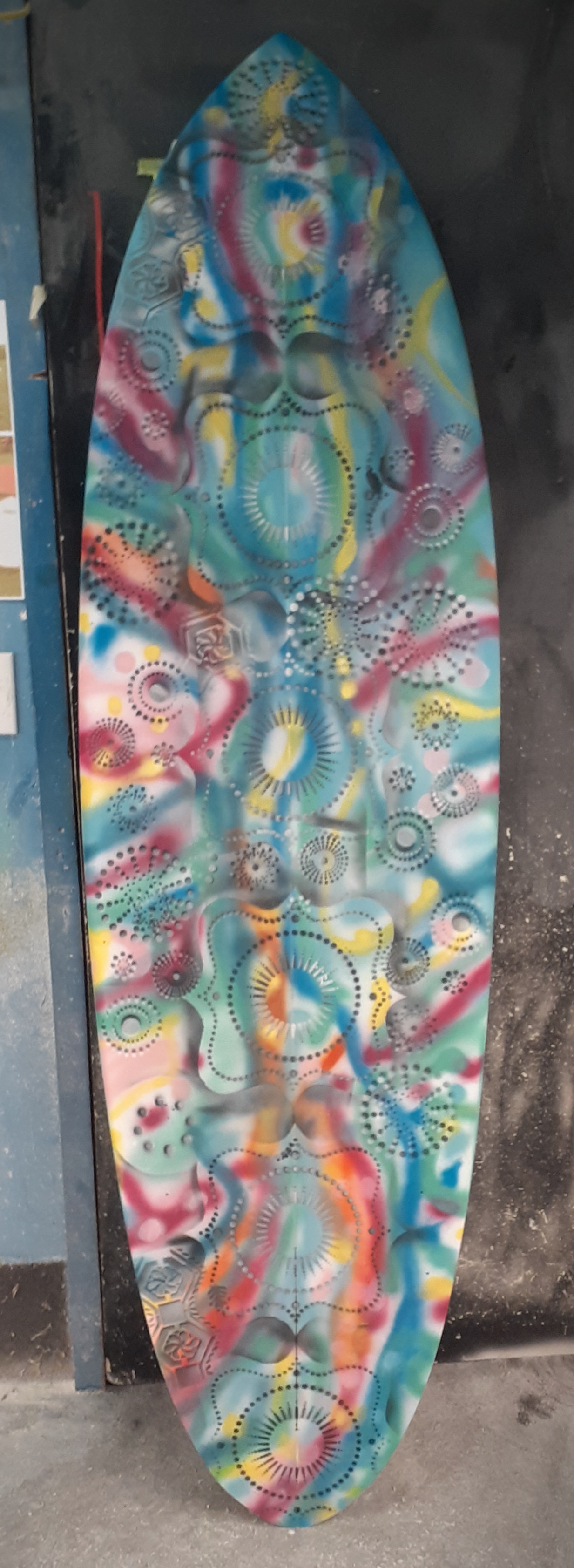

New sleds have been under Brand Ambassador aka BF Poster Boy Derek Thomas. DT just turned 45 recently as is still super fit and tearing up Nicaragua. He's back for several week and snapped "Marmalade" his 6'8" after taking off on a 15 foot face, getting pummeled with his head meeting his board in less than amicable circumstances while underwater. His 6'0" BFDE (Double Ender) is alive & well.
I've shaped him up this 6'5" which is a departure from my norm as we are exploring other modes of wave riding. This one has a Downrailed Beak Nose, Single Barrel Concave going out to a flat tailblock with some flip. It is a 2+1 setup which Derek loves to play around with Twins & Single fin options. I also have a 5'4" Twin started until my back decided to go south and remind me I'm a mortal human. I've been handshaping a LOT as of late currently backed up with 54 customs, shop stocks to replace plus Derek's stuff.
Sadly, orders piled up after mid August because, Mel, my wife of many years passed away and I took a month off living in a surreal world of loss and just letting myself grieve.
Here's some visual stuff, so I don't get choked up and keep putting one foot in front of another.

For the last few months I've been scheduling & doing what i call "Production Custom Runs" of my Models. This has helped keep the crew at Haakenson's with a steady flow of work including some finish shaping by guys I trust & admire.
By giving these guys work, I am able to help them meet their monthly expenses while having some income that can allow them to further their creative aspirations while promoting their own label. I am always in support of other shapers as well as Haakenson Fiberglass, Arctic Foam and U.S. Blanks as pillars in our industry.
All custom orders continue to be shaped by me personally, & depending upon the nature of the order, they are either shaped from a 'Raw' or 'Machined' blank.
Arctic has cut my files for years & the high number of cuts keep the blanks very close to finish allowing me to maintain a high degree of Desigin Integrity. Consistency is king when it comes to Reverse Engineering, and I only justify the approach when you are doing Models and have the Volume to justify doing so.

TRI PLANE HULLS (TPH) RETURN!
The original Greenough/Brock collaboration was quickly embraced & promoted by Al Merrick back in the 70's. The precursor to today's "Edge" surfboards, the Design offers High Lift, Low Drag Flyiing Wing Surfing characteristics.
The Rail Chined Single to Double Concave Design loves trimming high up on the Wave Face then Swooping Down with Speed to Spare for Career Making Bottom Turns. Pump this Sled thru a Series of S Turns for Section Making Speeds.
