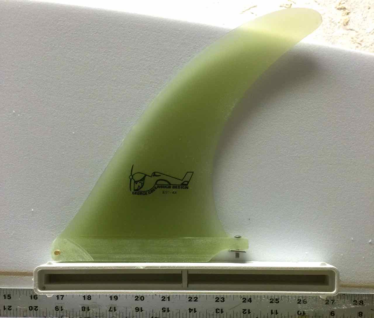

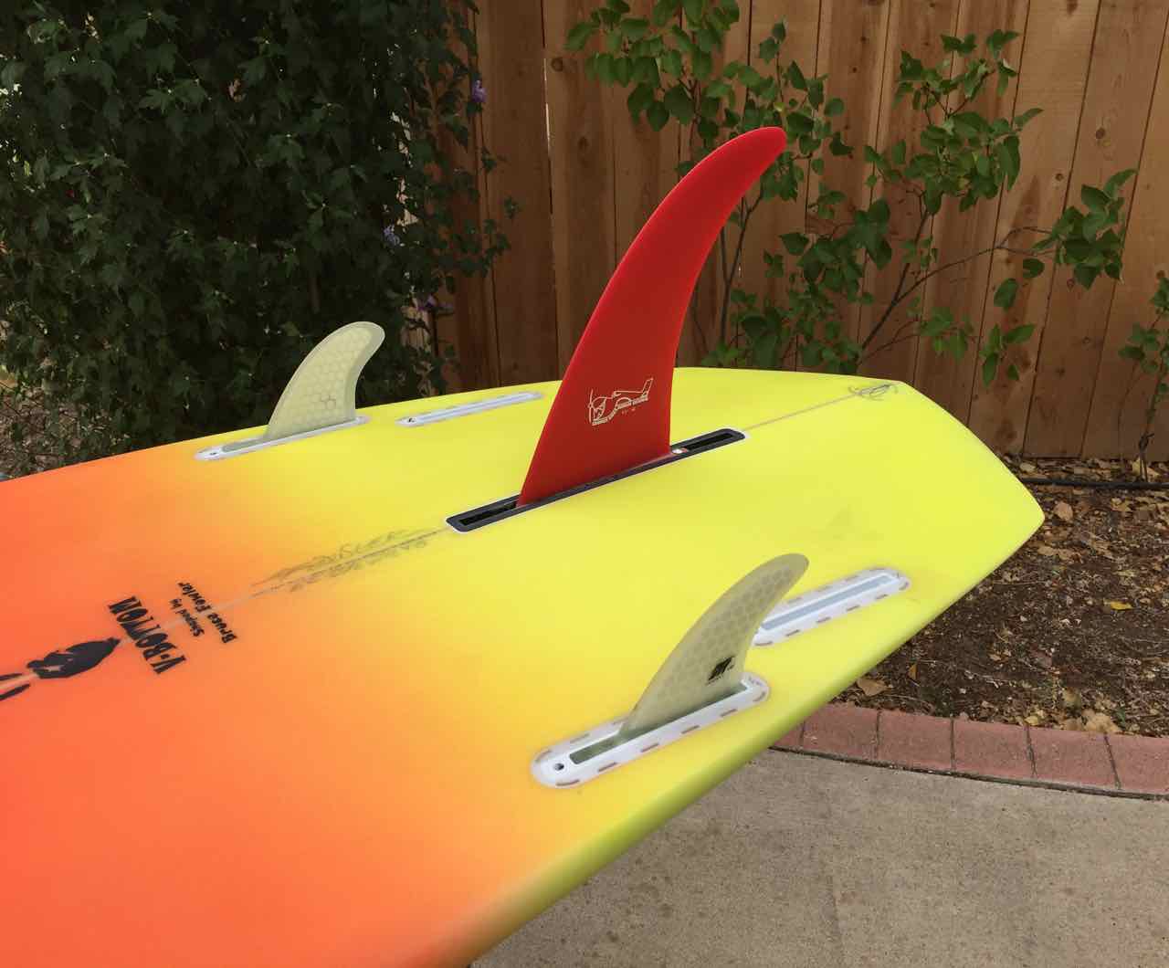

As a designer, I'll suggest you add more fins or go with bigger ones ..... after all, fins create drag so you have "directional stability"...... keyword: directional. Think about the earlier post from Cyrus in Hawaii: paddled like a ten footer and turned like a six footer with crazy speed, stoke blah blah...... not a bad problem to deal with eh? I think he has figured it out from the get go!
Here are just a few options you can play with if so inclined...... HAVE FUN!
Footnote: The Greenough Stage VI (6) fins pictured here have initially proven too 'positive' (stiff) in small surf. To date 8-1/2" to 9.75" Greenough Stage IV-A and flexy 10" Alex Knost fins have worked well in nearly all sizes of V8's. Start with your fin at least 10" up from the tail but better at 12" up then inch back a little at a time if needed. The boards ride better from a forward position.... they are NOT TAIL RIDERS.... fin forward, rider forward.... if the board feels squirrley, you are standing too far back!

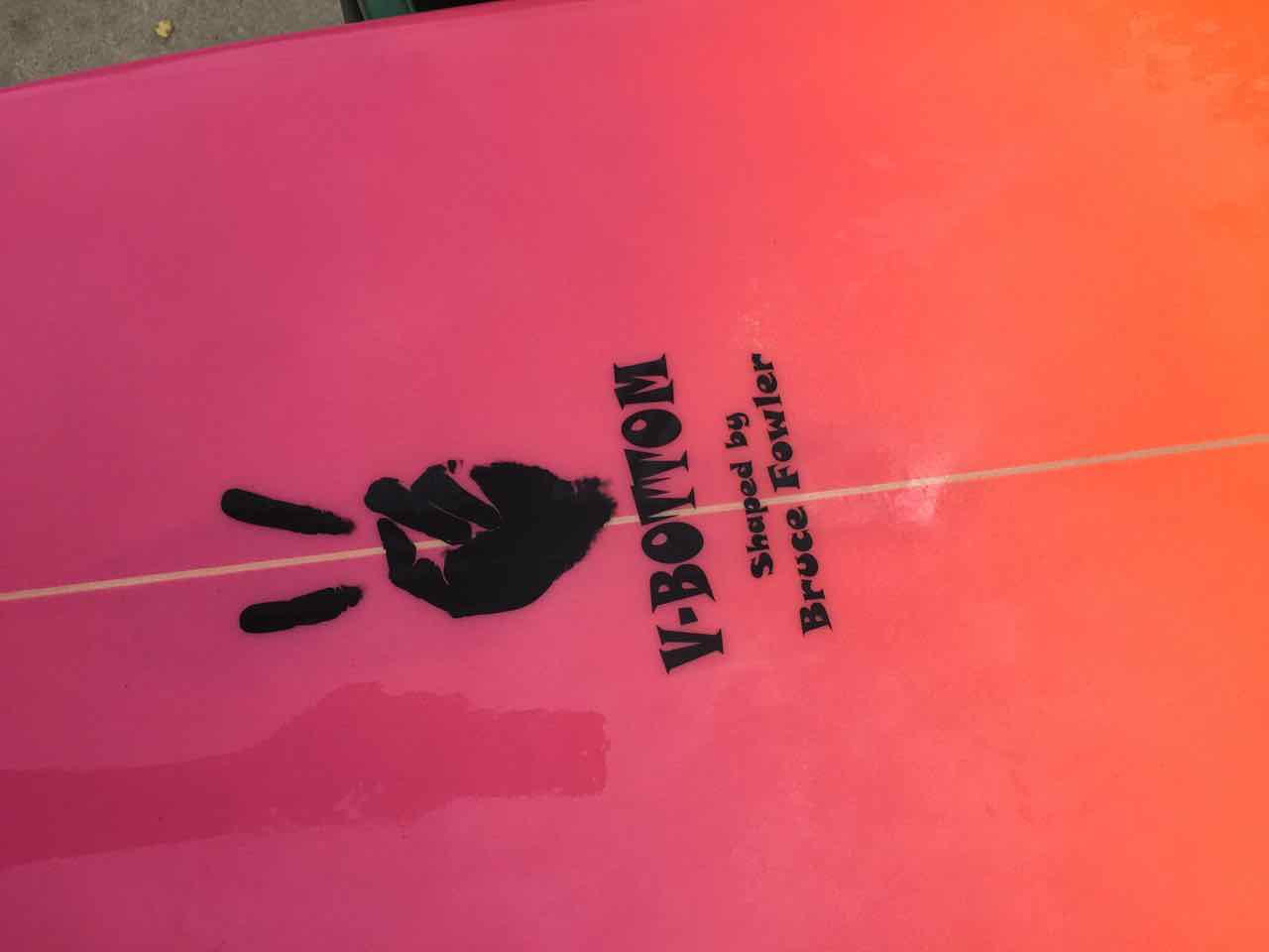

My previous ranting has been edited to PG level:
V8 V Bottoms are NOT a displacement hull or tail riding longboard. If you try to tail ride them they will be squirrley. Control comes from pushing the fin forward & moving forward. The design was intended that way and many people are digging them for the very reason that they do provide a different experience from the norm. I specifically kept the ability to spin out intact, which was viewed as a "problem" with the early designs back in '67. By going back in time, then continuing to develop, improve, and refine the design from that point on.... so it could possess greater capability, I feel I am honoring and furthering the lineage versus just merely copying something we shaped back then. I said a few times sonehere along the line, it was Midget's and some other photographs that inspired this current design jag I'm on. That speaks volumes for the power an image can invoke.
I wanted to retain that ability of slippage or drift, as was one of the original comments Midget made about his first v bottom. and the fin he designed for that board. My intent is to enable good surfers to use that as a tool to further their surfing on this unique design. If you want posi-taction, you are turning closer to center of the board with the fin positioned a foot or more up from the tail with a minimum of 10" for nearly all the sizes to enable the boards to pivot carve while burying the rail deeper into the water. As the rider ges the board wired, he/she can fudge their foot position back further and there will be more drift..... to the point that a good surfer can powerslide the board turns or cutbacks, and even perform a controlled spin out. Honestly, people that don't get the design intent, shouldn't even ride them. I'm not gonna make these with a standard tri fin thurster fin configuration or a single fin box set further back toward the tail because I don't believe they will even work. A quad is a different matter and the feedback so far has been very good along with the single fin option.
For that reason, I'm offering them as single & 4+1's. Anyone wanting to ride the 4+1's as a 2+1 is welcome to play with them. If you want a looser 2+1 put the outrigger fins up front, for more positive put them in the rear set of boxes. The boards are meant to play with different variations of fins, and as intended, regardless of the fin setup, everyone has remarked at how FAST the boards are and how EASY they are to turn "even with that wide tail". All of that was, and is, the intent of the design. If you want to pose, and noseride, and swing the board off the tail, go get a long board, that's not, nor ever has been, a V Bottom.

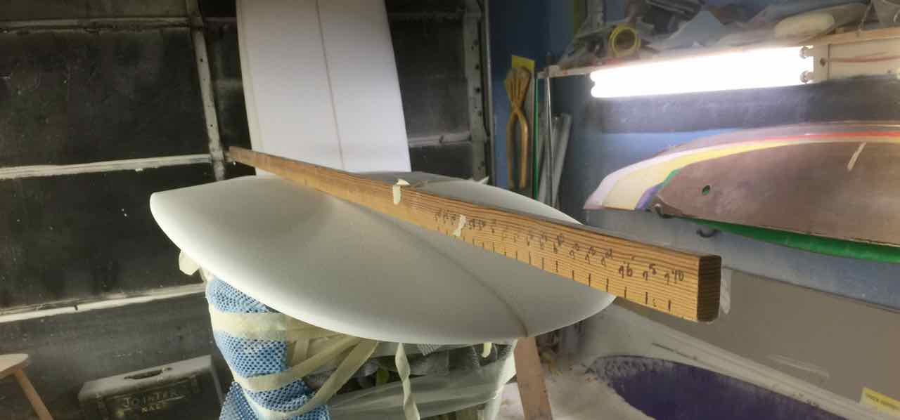

As I previously mentioned I'm working on some new models for release. Some are pulling from my previous experience which will deepen my offering to the public. I'm trying to avoid having too many models look virtually the same! I see a lot of that on guy's websites, and I have to wonder how that's working for them? I'm not a real big fan of useless redundancy.
That being said, I recently shaped up some boards that have seemingly been around forever. This semi double ender shape works in every day waves regardless of where you live. It's kind of funny because I look at them and picture labels of all the big companies from the 70's that had a version of these.
I also have kept the glassing and color schemes more reminiscent of 1970's: the era that these boards were so prevalent.
Finally, I've updated the foils, rails & rockers for some efficiency, which should optimize paddling, wave entry, & speed. I think they'll offer a smooth riding experience for all skill sets of surfers both young & old.
The new Diamond Tails aren't too shabby either. These are more foiled rails, thinned out tails, deeper vee promoting fast vertical surfing. The accelerated diamond tail shortens the rail length for easier turning and more vertical capabilities than the v machines aka Plain Janes. Kind of a half step up from the earlier design while retaining great paddling and early wave entry.

Here's the 9'0" cutout eyesterday and the three will go into glassing today. Wish my shaping room ceiling was taller.

The quad box test will allow us to explore quadramania more but also opens up the choice to run the board with varying main fin sizes supplemented by either 2+1 fins forward or behind the center fin desired. Those choices will deliver a looser more pivoting turn from the forward fin choice, or more posi-traction with 2+1 fins equal or behind the main (center) fin driver.
Shawn asked me for the quad option, and I decided to go ahead with this direction because it plays into the torsional flex off the panel vee due to the leverage positioning of the forward & rear quads. I'm not opposed to exploring that dynamic. Obviously it will be different from the center fin driving positions we are playing with.
I'm currently designing two different types of fins for the center fin positions. The current status quo fin out there is stiffer than what I want, which has me refoiling them for flexier tips than what is currently available. I don't accept the claim that the Greenough's and some other "flex" fins will naturally "break into the correct flex pattern" in six months or a year?!! The chord has changed since the early 70's and we could flex the tips 1/8 of an inch side to side with your little finger...... this is what worked then, and this is what I'm after for one of the new ones I'm designing.
