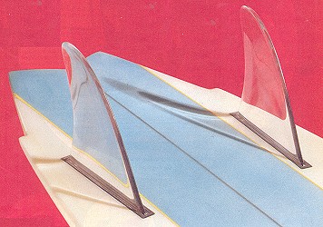

Lets take a journey back to late 70's with G&S Star Syetem fins which we were contracted to make their fiber glass fins for them at that time. Here is a Twin fin board with the fin boxes installed after the lamination along with another board made in 1979 with plastic Twins.
Coming into the early 80's California Finsystem came out. Boards like Wave Tool used this system alot for bigger Twins.
Then coming into the mid 80's Ofish'l hit the market.
Then in the late 80's Freestyle finsystem. Again install after lamination. First Screwless fin concept!
Then coming into 1991 or 1992 what is now called Future Finsystems came about.
You guys know where I am going with this I think, should answer some questions. But I will explain more in tech!

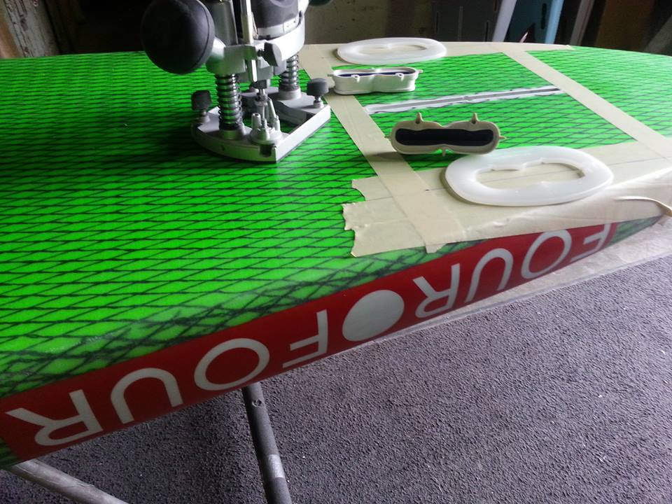

Lets see photos of you installing with the glass sock. I'm curious if you're letting the sock extend up thru the gap (above the board bottom). That would be ideal. Sand off excess after resin goes hard. But it seems like a fussy thing to deal with glass sock getting in the way of the tabs. Then you'd risk air voids.
I've been wrapping my boxes with 1" wide glass tape. Two full wraps, then stuff it down in the hole. I use a popsicle stick to poke any glass sticking up, down into the slot gap. Never had a box failure set in 1.35# EPS.

Joe Blair gets it, in the Standup world which is the opposite of the Surfboard world. In the Surfboard Prone world you are catching and riding the board more off the tail. In the Standup Surf world you are riding off the balance point of the board which is further forward. People look at only one eliment of surfing which is riding the wave and forget you have to paddle with a paddle which is different than catching a wave on a Surfboard in simple term.
Probox Install is designed to adapte to any board bottom. With a flang glass over you are shaping the board around a finsystem which is ASS BACKWARDS, unless your board designs have NO tail rocker or curved bottom contours!! Another funny thing is a glass over is a polyester mainly install. With so many different board structures these days i see installs that are done like Probox after lamination then glassed over which is more work, go figure.
Dwight, I talk about the sock install on my blog www.Probox-Larryretrofits.blogspot.com
