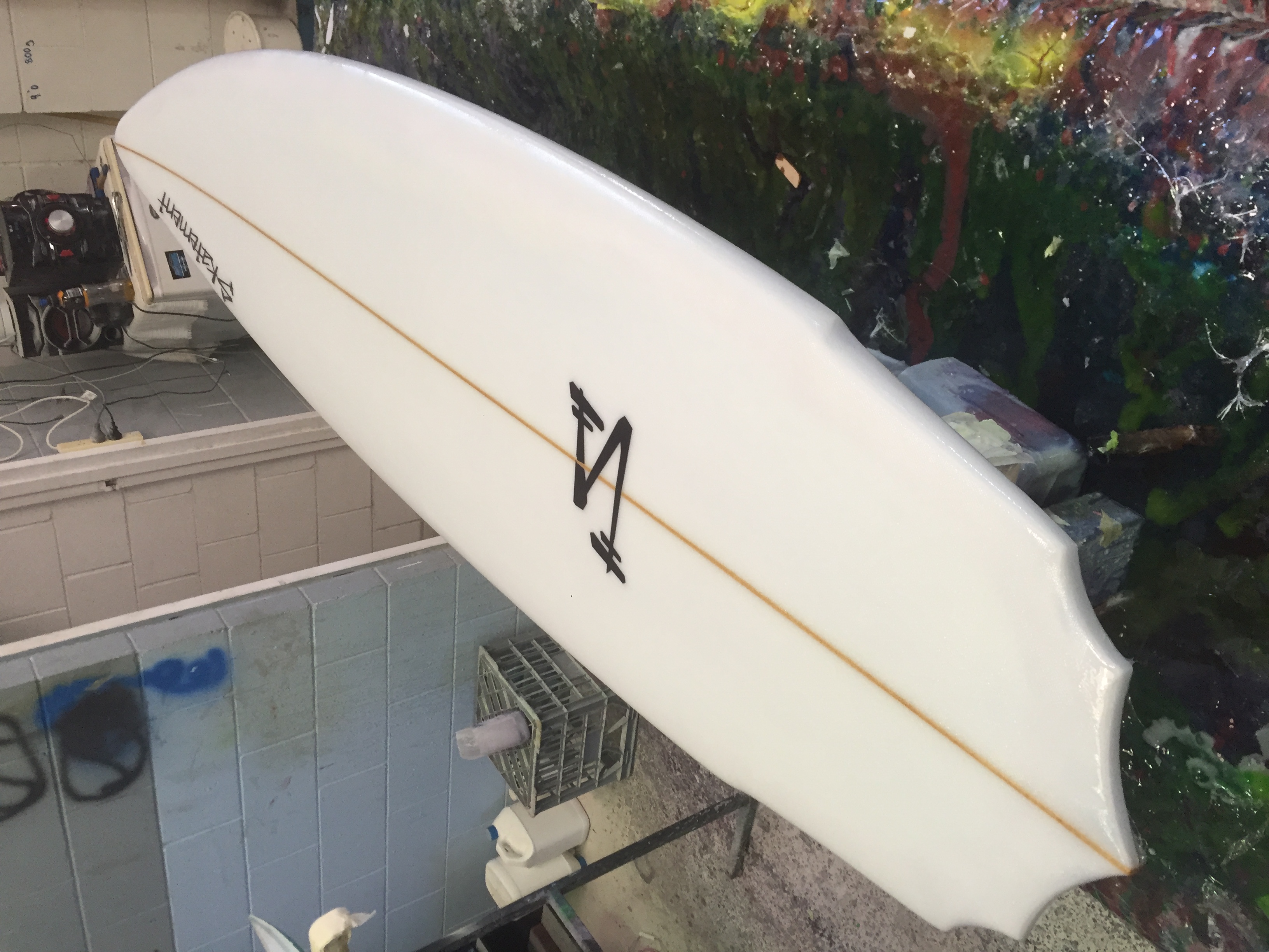

The board
It's 5' 6 5/8" 18.5" by 2 3/8"
The file I made up for it was 5' 8" but I blew over in the wind in my Staffroom and the rounded nose was born. I kept it fairly volumous to help me paddle it and keep it daily forgiving.
It seems to be going extremely good. It has a wider tail and more straight outline through the rear of the board means it can accelerate super quick and the bat tail and the step in of the outline means you can use the extra rocker on the rail (still fairly low) to turn the board at speed. And the reduced central rocker due to the large single concave in the middle (that's been split up into 4 concaves) allows the board to get up and plane and lift and therefore go fast really easy
It seems to have encouraged me to get low of the bottom and lean into some really centered bottom turns into some good top turns.
In smaller waves the complex bottom concave in the guts seem to not like the hop between sections but if I get some forced upper body rotation and fin drive it allows me to get through sections better and be almost prepared for a carving turn when the section pops up again.
The enemy of this board in smaller stuff is standing still. It just doesn't plane very well at low speeds. But I have grovellers for that. If the waves are bigger it's easy to surf standing still but who wants to?
The fact I have not put the complex concaves in the tail is seeming to work well in the weaker waves I have to deal with on the Sunshine Coast. Seems to allow the water to flow out of the belly with easy speed. Seems to let the tail come around nice. I've only surfed it as a thruster so far. I've got some quad trailers in the car. It I just haven't put em in yet.
I've been surfing it in SLOP and a few good waves and I'm equally as stoked on it. Due to the low rocker there have been a few times I've aimed at a smaller steep section coming off the top and bogging as the board releases from the wave surf face but this is due to a lack of technique I needed to commit my upper body over the front knee and flow down through the turn. It I was under rotating and dividing down the line too much. In good waves it has just been super nice.

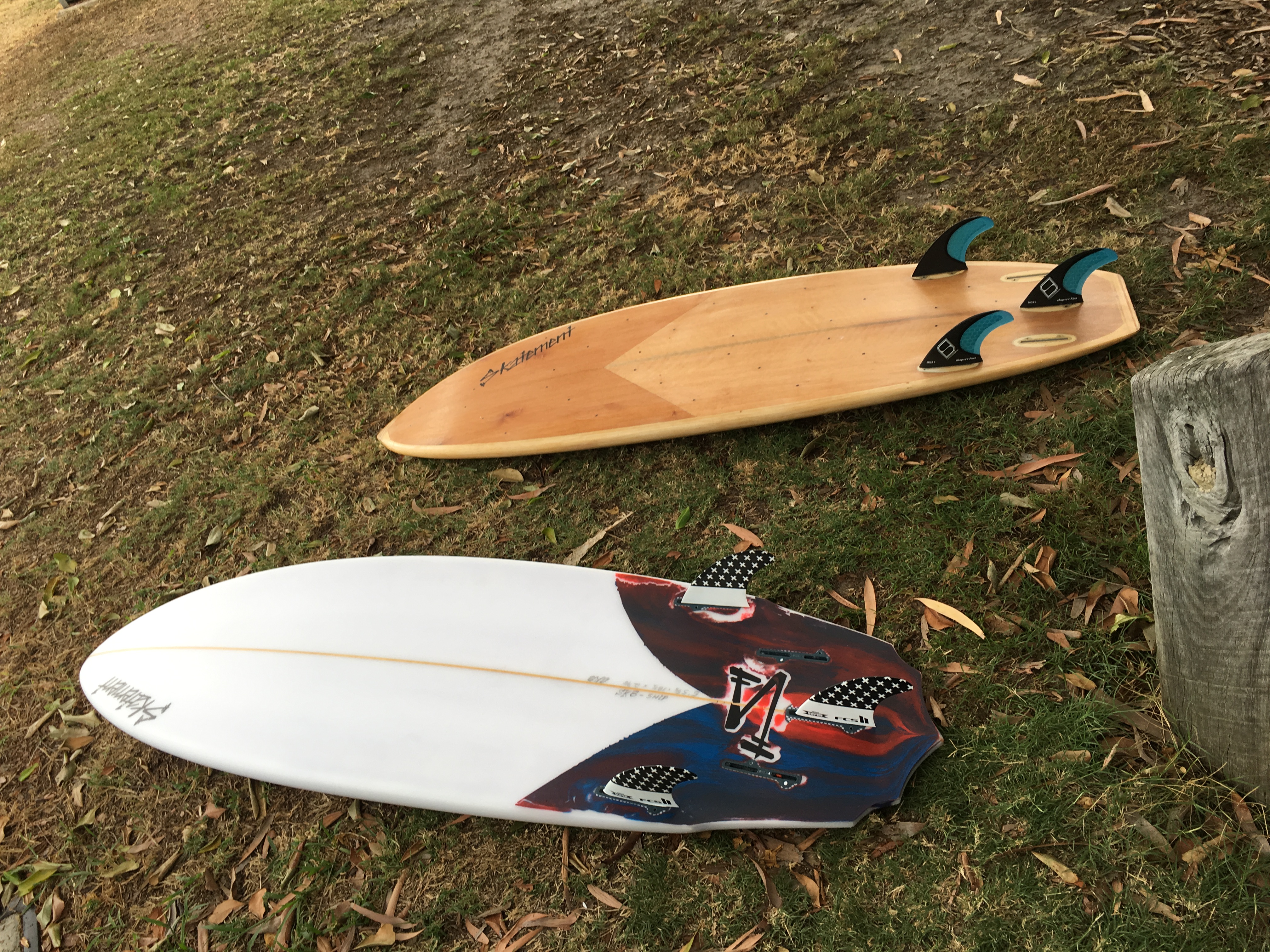

I also got these few pics the other morning but they were with the quad set up. The first two shots were two turns from the one wave.
The last shot is after surf froth this arvo.
