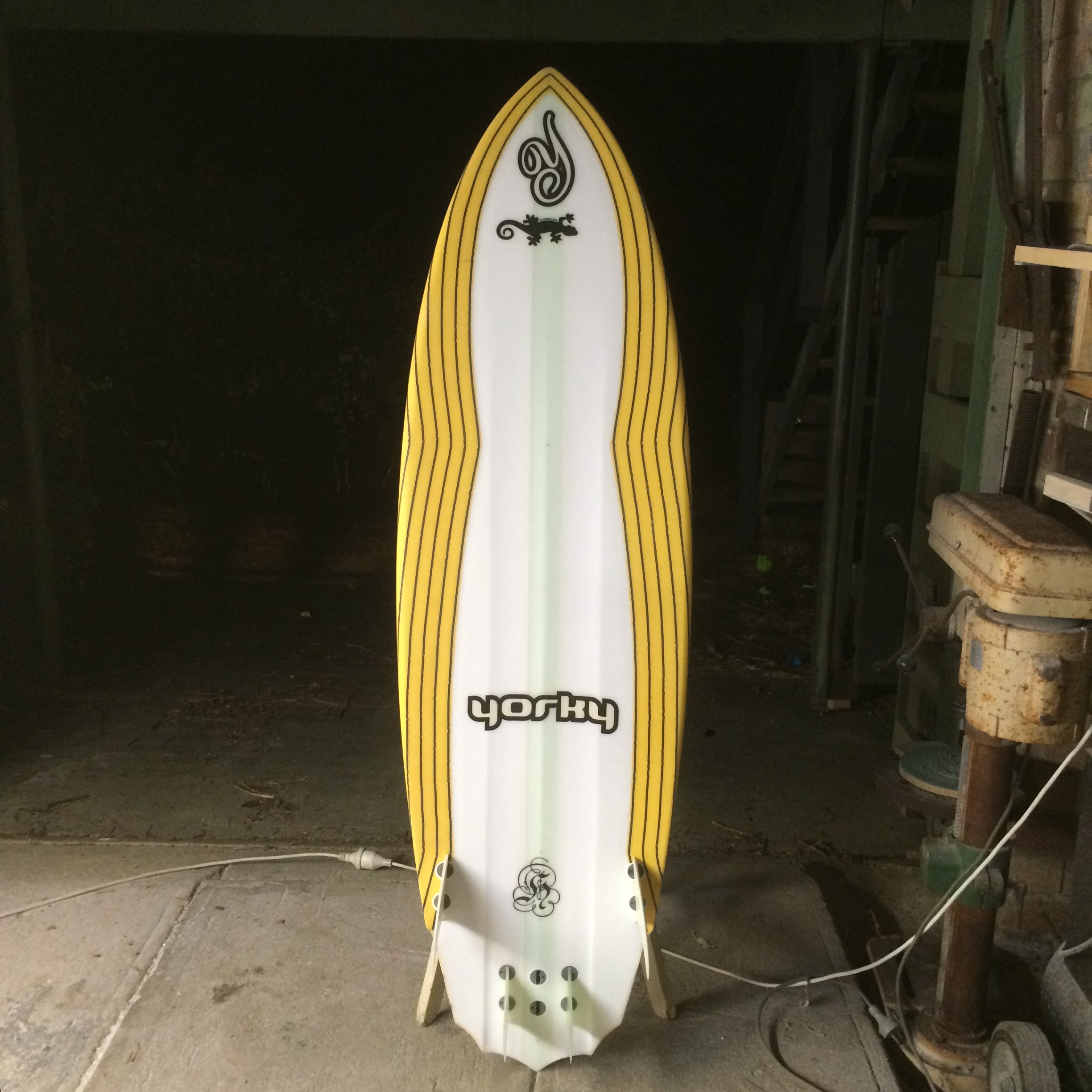

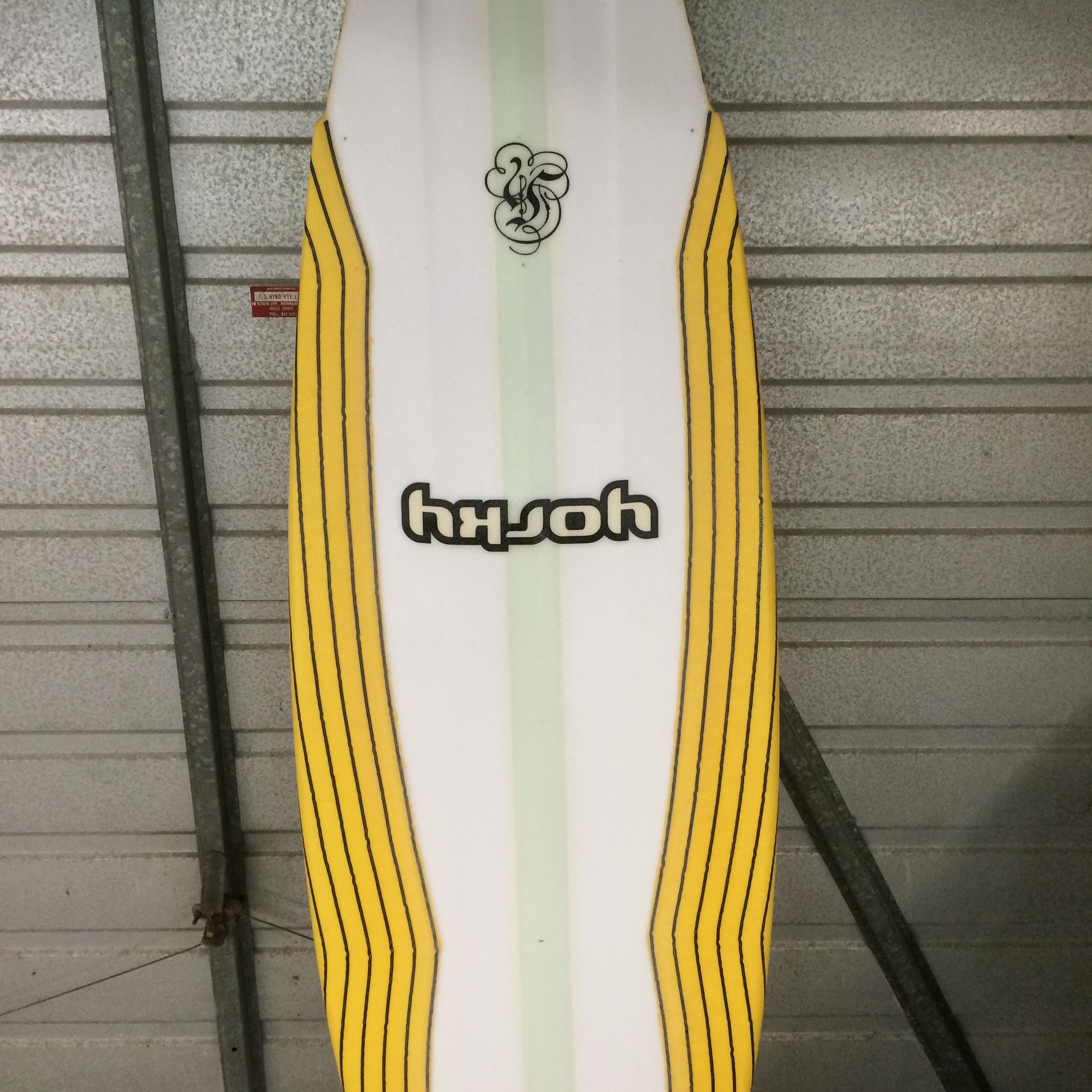

I laminated over some carbon strips.
It's 4 oz plane weave rail to rail, so, nice and light this time (I drained the shit out of it too)
... Lots of decals (the gecko is a hand shaped sign from a while back), old school grom style.
No futures plugs, were doing dual fcs1 plugs this time. To see how much flex it can handle (I plan to snap this one). Futures plugs lock the tail flex up way to much... For me, any way.
The carbon lay up way hard to say the least.
Bottom is one layer of 4 oz.
Top is a 4 oz insert with 2 oz over top.
... With a few twists and turns along the way.
I used water based yellow paint. I Applyed the paint in the carbon tape up lines (The blank wasn't sealed - the paint added a very minor sealing of the blank, for when the epoxy was brushed on for the carbon application).

It is a butt ugly board haha (a one off thats for sure)
I'm not going there with the carbon lay-up again. How's how weird it makes the outline look from the deck lol
oh well... It's nice and light this time around.
