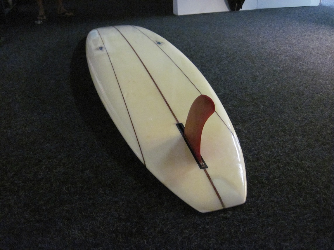

Monday I have a trip planned to the SHACC museum in San Clemente for a look at some real McCoy vintage wood boards, like the last pic!
Today I got a great tour of the Surfing Heritage and Cultural Center by docent Uncle Grumpy, and it was awesome! Overwhelming, you would have to spend weeks there to begin to absorb it all. Saw so many awesome wood boards. And a peek at Velzy's shaping setup and tools.

One of the biggest lessons of my museum visit was all the imperfections in those old wood hand shaped boards, but you can also see the love of the craft, and you can see the human touch. Wood is naturally imperfect, in the computerized / machine manufactured sense, so it invites a more "hand hewn" approach, at least that's been my philosophy on this. Meaning I'm giving myself pemission for stuff ups as long as they're fixable!
