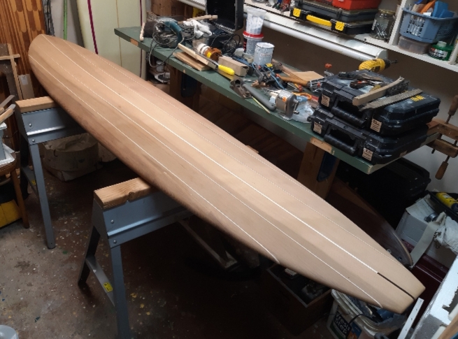

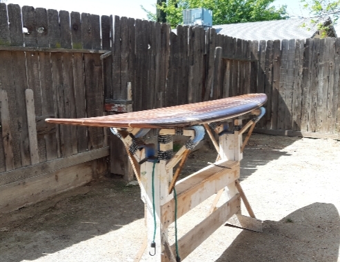

Taking my time with the finish shaping. Enjoying the challenge of working with wood. It's different from foam, and different from a hollow wood surfboard over a frame.
Everything was shaped pretty close before chambering, but now it's about fine-tuning down to a finished shape. Putting thought into every stroke, and hoping for the best :-)
If I had it to do over, I would clean up the bottom, then cut it into 2" strips with a band saw. Using the band saw, cut my center stringer profile from each piece. Tack it together for shaping, then break apart, chamber, and reassemble for final shaping.
But I thought I might be able to shape and finish it without cutting it apart (wishful thinking I guess). And I really did want to experience shaping a big chunk of wood. So it's all good. :-)
That missing center stringer in the tail, I assume you are going to glue in something a bit more exotic and stronger with a built in leash loop holder?
Had to do a little mental imaging to get the picture. I understand what you are saying. Other than flattening the bottom; all your shaping would be at the end.

@McDing - knowing now that I ended up chambering, this would have been cleaner, faster, and the leftovers would be more useful than chips and sawdust.
And 2" wide sections would make chambering much easier, and no matter how twisted, be easier to bend back to conformity in glue-up. Now I know :-)
Mixed some resin, thickener, and pigment, and filled in the little cracks crevices and wormholes.
I used resin & thickener cuz I needed to pack it down deep into some of the stringer gaps, and I had to fill & sand to shape in a couple gaps around the edge.
But it was hard going on the clean-up sanding, for sure.
At this point in the process I feel like Reverb - all I can see is a thousand little imperfections, irregularities, low spots, high spots, lumps and bumps. It's pretty well shaped, so this is what I will work on tomorrow.
I wanted a very old school flavor to the shape. No concaves, and no hard edges. A little belly up front, little V out the back, and a little pinch to the rails.
Current weight just over 24 lbs. and still feels heavy as a bucket of nails to me.
Don't overly sweat the tiny stuff - while getting it as clean as you can, wood has a mind of its own.
At 24, you're doing great.

OK. I had it sealed, but then I got to thinking about it, and I sanded it down again. It happened when I was explaining to someone "whats so special about that wood".
And as I was telling them about "old growth", how it came from a forest not a tree farm, and how you can't get it anymore, and how rare a piece that big is with no knots whatsoever, and what vertical grain is and why its the strongest and most stable and most beautiful, and it dawned on me I needed to spend a little more time on it, with a deeper appreciation of the wood itself.
It really is a remarkable piece of lumber. So I had been thinking about shaping, and how much harder wood is than foam to shape, but then I shifted to being completely grateful to work with such a beautiful rare piece of wood. And I sanded and sanded, 60 grit, 80 grit, 100, 180, 220, and that grain really began to shine. I got rid of all the little scratches and finishing flaws I just blew by before.
Plus, it gave me the chance to make a few tweaks. A little more V in the tail, just a hair more belly in the nose, and little more work on the rails, a little more work thinning out the foil. So I am much happier with it now. And the weight went down to 23 lbs.
But its sealed now, and ready to glass.

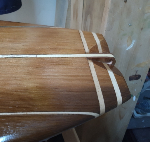

So I have some decisions, and I invite any feedback: Leash loop, do you like it? I know its not "period correct" - there is no period correct leash loop for the wood board era, and I never set out to be 100% tied to a time period. But I did want something appropriate to the board.

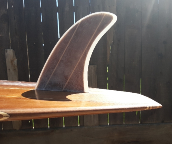

Fin: I shaped a fin from the same wood as the board, but it looks foggy with weave showing (epoxy over dark color sometimes does that). It looks a little worse in the pic because it has been sanded, but it really does show the weave. Should I just leave it, sand it down to the wood and try again, or just buy a cool wood fin? Glass on or fin box? I hate to put a fin box in, but it sure is handy being able to take the fin out - even if it ends up a wall hanger, a removable fin is nice. If I go with a glass on fin, I am thinking of mortising my fin in, for strength & less gusset, any thoughts on that?
The board looks great as just all wood, but some of the old boards did have some cool artwork or lettering.
Also, thinking of a name for it that will reflect its purpose: to honor the great old wood boards and wood board shapers that are our heritage.
Great job Huck , I vote for a removable fin , and in my humble opinion the fin should the light color wood , but what ever you choose it will be spectacular , aloha T .
Hmmm, I don't have much choice, I can only use the offcuts that are big enough, and whatever grain they have is what they have. I can rummage through my box of scraps and see if there is one big enough for a fin with the lighter grain color. But if I put a removable fin in a finbox, then I will probably just buy a fin. And if I buy online (the only way right now), I can't be sure exactly what color I get. Then again, maybe I could build a fin with scraps of the light wood and strips of balsa to match the board... decisions decisions. Gotta check that box of offcuts!
This is the fin I liked the most from my visit to SHACC. I'm pretty sure its (board and fin) a Phil Edwards design.

I have made some fins using the same cedar as the board they are intended to go into, for the same color. I like the consistency of color/grain from hull to fin, but something with more contrast is not going to be able to make your board ugly, no matter what. Let your inner artist and the materials you have on hand, or can easily acquire, guide you.
Perhaps use the same or similar color but much stronger wood as you used in teh stringers, like a white ash or Holly, perhaps 2 lighter stripes from base towards tip raked back. I'd skip the fin box and definitely mortice and tennon the base, with as minimal a fillet as possible.

Instead of a leach loop pronounced above the deck, could you dig some cedar away and recess one?
I think it should be 'hidden' rather than pronounced, but of course that's just opinion.
I like your fin. It's suitable for the board if you can get it to "clear" up. But many of the wooden fins on the old boards were a little cloudy. I understand a contrasting fin and like that as well. If it were possible to visit a Home Depot I would look for some Basswood, Alder or Poplar for contrast. All three glass up nice and clear. I would guess because of the lesser oil content. Old boards or Replicas usually wind up with a resin/glass leash loop or a "stick on" like O'Fishl used to make. Ther idea was that they could be ground off if you ever wanted to retire to original or make it a wall hanger.
That which can be assorted without evidence was read in an illegal magazine.
Yes, A removable fin is the call. Too many disadvantages otherwise.
You have done a masterful job with it. I hope I get to see it live someday.
As for the fin, Juan Rodrigues in the Sarasota area is know as a master wood fin builder. He builds wood fins for all the old classic boards. His website is One World. But you can google him.

I kinda like your leash attachment - definitely "in the spirt of" rather than a copy of anything. Otherwise a simple glass leash loop would be suitably discreet.
For the fin... this is your call and I understand the dilemna. On one hand, a box and removable fin (Juan does beautiful work indeed, I used his fins for years, and Dingpatch on Jamboards also makes very functional stunners) is great - you can open a lot of possibilities. On the other... a board like this is going to be particular in the water with a nature all its own and an adapted glass-on (I like your template, by the way) would not only look great but reinforce the mindset that you're riding and learning about the board as it is and for what it is... plus less chance of an eventual leak, etc. Light or darker wood? Both would look great.

My initial thinking was a simple but "primitive" leash attachment, like something that the old wood board makers would have done if they had to find a way to attach a leash. Hence, the wood leash loop. I've never been a fan of resin/glass leash loops. I guess they always look like an afterthought to me.
But something about it bugs me, and I guess I don't like the way it bumps up. I kept thinking an "innie" would look too modern, but seems you guys agree it would look better than the bump. So now I'm thinking something like my tail block attachment. Wouldn't be too big a deal to cut it off and put a regular tail block on if somebody wanted a wall hanger with no leash attach.
As far as the fin: I'm really torn. I agree with Greg and Trevor, the convenience of a removable fin is a huge plus. But I'm really drawn to a glass on fin, for aesthetic and conceptual reasons.
I just really hate to put a plastic fin box in this board, it seems almost a violation to me. Like a plastic leash cup would be (to my thinking).
If I do a glass on, the carpenter in me wants to mortise a slot for a fin base to fit into, for strength. Any thoughts on this?
I looked at my fin, and I could get the shape I want (I like the shape it is now, but I keep looking at that Phil Edwards board I showed a pic of, and I just really like that fin), and add some contrasting lines of 3/32" balsa stringers to match the stringers in the board. I could make it a removable fin box fin, or a glass on.
Yes mortise it in. Much more secure. At this point I would just stay with the leash loop you have. It looks to me that if you ever decided to do away with it that you could just grind it flat and replace it with something else. I have always been a fan of the "drill thru" leash attachment on classic longboards because they are stronger and don't detract from the classic look of a longboard. That's not an option for you here without a finbox. The board deserves a classic glass on fin. The resin loop was always an add on to old boards. So that wold be appropriate because that is what a lot of guys did to old boards that had been in the rafters for years. Of course they also drilled thru the fin and attached a leash with parachute cord.. I am definitely not in favor of that. I am quite sure that if you put your mind to it you could come up with a flush or as you say "innie". It's your board and your style. And you are known for these types of leash loops. If I saw a board anywhere in the World that had a leash attachment similar to the ones you have done; I would immediately wonder if it was one on huck's boards. It's your signature. Leave it. At least for the time being. Lowel

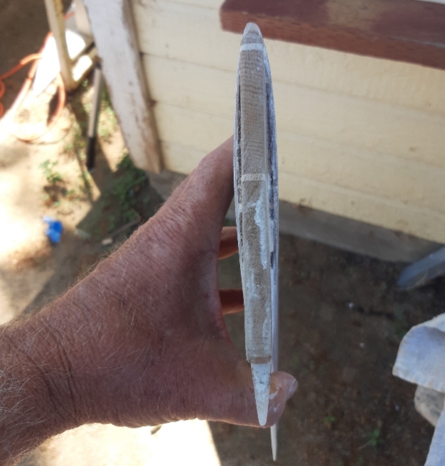

Ok. Added some balsa strips to my fin, and re-shaped it. Like it better now. But I need to glass it all over again.
I did a tail block leash attachment and I like it better than the beetle bump.

Your fin looks to be pretty high aspect ratio. Such fins usually need to be further back than their lower aspect brethern. Not sure if your pic shows where you intend to put the fin but I think it is too far away from the tail.
I like the idea of a hardwood receptacle routed into teh board, to fit the current tenon. I've put a lot of though on how to replicate a Bahne box in wood and always gave up as the 3/8" width it too limiting, but you could much more easily make a box to fit the tenon your existing fin has.

The fin I have now looks high aspect ratio, but probably not so much once I glass it and the halo is added to the outline, and the wood at the bottom is gone. It is based on this Phil Edwards fin, and I will probably use this photo from the SHACC visit with UncleGrumpy as my placement guideline. So you're right about placement being too far forward, but I just set it there for the photo without any serious thought, like when I actually set it in place for glassing.
I don't have a lot of experience with glass on fins, but I do want to avoid sanding a lot around the fin and sanding though the seal coat, or the weave, whichever it is. I do know from experience, and from repair work, that working around a glass on fin is always more work than a fin box.

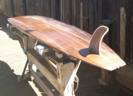

I put two layers of 6 oz. on my fin, just waiting to sand and clean it up. I posted up some questions in a separate thread. My plan is to mortise it in, but no glue or resin, just held in place by the fiberglass on the surface. So if it hits a rock and breaks off, it won't tear up the bottom of the board too much. The tab and corresponding mortise will be a little wider than the balsa stringer, so the balsa stringer won't be holding it, the cedar will.

I also really like the look of the fin with the balsa stripes. I do question its strength with only 2 layers of 8oz up the sides. The balsa has no strength and the cedar is hardl a super strong wood. I'd expect breakage along the grain by the tip if it hit sand fin down and pivoted. I know you will add more glass when glassing it in/on. I'd encourage knowingly losing some clarity for greater strength as I think this board is going to be a rider.
Regarding glassing the fin on/in, assuming you are still morticing the base, I think the fin should be installed after laminating. The question is do you route the mortice before laminating, or after.
Before allows you, with epoxy, to come back with a razor when it is ticker and gooey, to slice the fiberglass and fold it down teh sides of the box. But resin puddling in teh bottom can be an issue, and its not like you can completely cover the inside of the mortice with the cloth wrapped around the edge.
You could wrap the base of the fin with some freezer zip lock bag, and push some cloth into the mortice using the fin base after slicing the thickened epoxy lam over the recess with a new sharp razor, or perhaps some scissors to get into the corners.
You could not use a razor at all and just lam over the routed recess then route out the cloth, and then line the box with cloth as you have done with some previous probox installs.
You could also just cut off the tenon and glass the fin on like they used to do, with a rope fillet way up the base and several layers of cloth up the sides at the same time.

I do have a rail shot somewhere, but will post up a few more. I did really foil the nose and tail more than usual, the downside is that when I did my leash attachment tail block I didn't have whole lot to work with. I guess if a wave ever yanks it hard enough to damage, I will just do another, since tail blocks are not really too hard, and then I will count my blessings to even be back out in the surf post-pandemic, haha. In reality, the design itself is very strong, I didn't use plywood on this one, but the side layers are 90 degrees to the center spruce, then they are pinched between the tail block pieces, with fiberglass. There is a copper tube epoxied inside. Its not bulletproof, but probably won't be an issue.

RAIL PROFILE http://bgboard.blogspot.com/2014/03/march-82014-afterr-seeing-recent.html
I agreee with lowel about this shape looking more refined than any previous you have posted pics of. I really like the outline and the bladier foil. How thick is it, about 3 to 3.25 I'd guess.

The fin has 2 more layers of 6 oz each side, not sure how many I can get before it just gets too cloudy, but I'm hoping at least 2 more each side, for a total of 6 each side.
