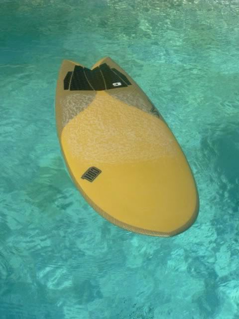

OK. That was funny. I've never used one on my boards. I stick a lump of wax back there to indicate where to put my foot, but technology moves on. Who knows? Maybe one day we'll use ropes tied to ends of our boards to keep them from .... I don't know.....floating off when the grandkids play on them? nah.
I cracked up on the ''shower mat'' comment too. I have a bunch of boards with traction, a bunch without. It kinda depends on how hard I'm gonna try to push the tail around.
This board is 5'10'' x 21,5'', 1.17 cubic feet. Flat bottom to a slight V off tail. Staged foil to heavily thin tail. A lot of volume is ''hidden'' on center, so most of the deck is domed quite a bit.
GT, you should do some more ride report, then I can talk about fiber choices, etc.
That kevlar springfish looks great, I even really like the color!

Hey I have the same shower mat on mine too! Actually my Coil fish is very similar to Mike's sans the kevlar. It's 5'8" x 21.25 x 2.5 and .96 cu ft and I'm 5'9" and 180lbs. I've had it for a few months now so I've got it pretty dialed. I've ridden it in mostly soft waves up to head high. It generates a lot of speeed on takeoff...once you give it that first pump you are flying. It is very thin in the tail area and this allows you sink the rail and turn much faster and sharper that you would on a more conventional fish. I can do floaters and vertical lip smacks on this board with ease. It's truly a high performance board in all aspects. With the quad setup I have right now(Future Controller Quad) I can push this board as hard as I possibly can and it will not slide out....but it's very loose and free feeling when you are coming off the top. I've ridden other fish and this board is my fav so far. I just wish I had one of these when I was 15 and hopping around in waist high mush on my thruster!
Mike...how does the kevlar "feel" compared to a normal Coil? Is it lighter?
rodbldr, not only are you a better photographer (nice pics) than I, you're also better at describing the kind of ride characteristics I'm trying to put in the shapes! And then Coil Construction gives 'em ''life'' and toughness.
The kevlar is normal weight, and a little stiffer. I shaved the tips even more than yours to get a little pop back - so far so good. It feels like a Coil.

Here is the kevlar Coil. I'll let Mike talk about it, but there is a lot of tech stuffed into a very little package.
Greg or Mike,
Any shots of the foil on that Coil? Especially, the tail. Board looks great. Except for the shower mat on the deck. To each is own..... Mike
"Except for the shower mat on the deck."
