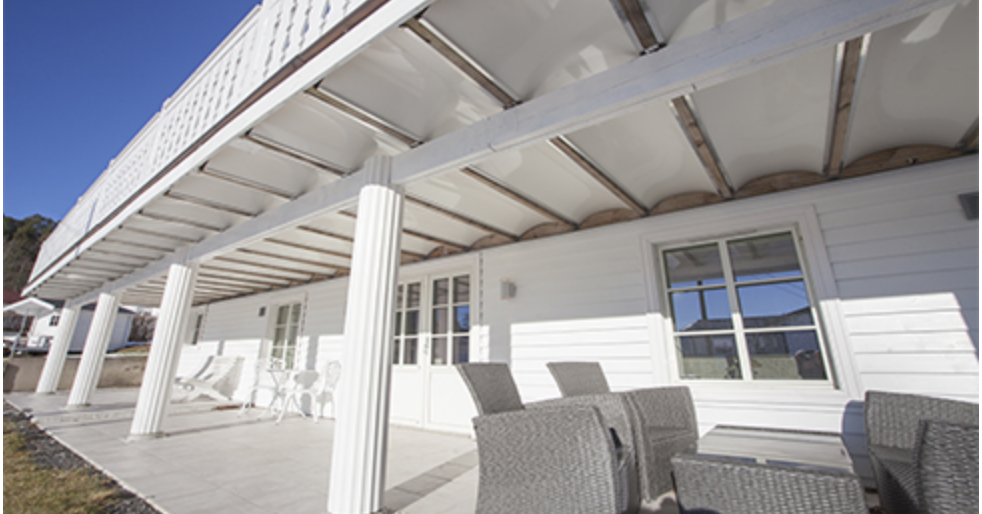

Thought I would add this here, I just finished a spin template I made out of pvc. 3mm, super flexy stuff.
Here in Norway they call them Drip Stop. It was so easy to finish, the cutting out was ok. No sign of cracking or breaking,
like plex glass will do. Ill see if I can find them online and what thyre used for.
